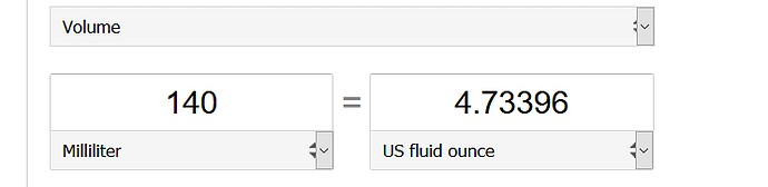

Interesting. The Porgressive 416 shocks recommend only 2oz of oil per shock. I just replaced oil seals in all 4 shocks and put oil back in we only used 2 oz per shock
Google says 140ml.
Oops, another place:
shocks on my 84 1200
the amount of oil the shock holds… 295cc to 365cc has been posted I used 330cc when I re-did my 1200 rears ATF.
Which is 10oz.
What do I know? :slight_smile:
