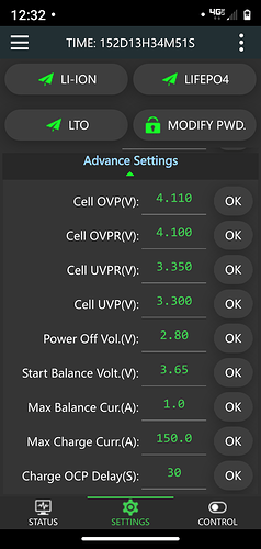

Be a little careful on which settings you change in the BMS. It will protect the pack only as far as what it is told to do. We should now go through what is in there to make sure the settings are in the comfortable range.
Post a few screenshots of the first and second tabs so we can help tune your rig.

Screenshot_20220610-123221
Screen Shots today 6/10
Those will work. I usually start off a bit more conservative on the high side.
OVP 4.0
OVPR 3.95
But that is just me.
If you are going to be doing range testing, watch close when you get to the bottom of the scale. See how fast it drops off in the last tenth and monitor how far you can go.
When this thing shuts off it will just kill the car without warning. Hopefully it is not pulling out in front of traffic.
If you set the UVP (bottom end) a little higher (3.4~3.5?) it will shut off earlier you will have a “reserve” to get yourself home if you aren’t watching. It all depends on what kind of range you need from your car.
