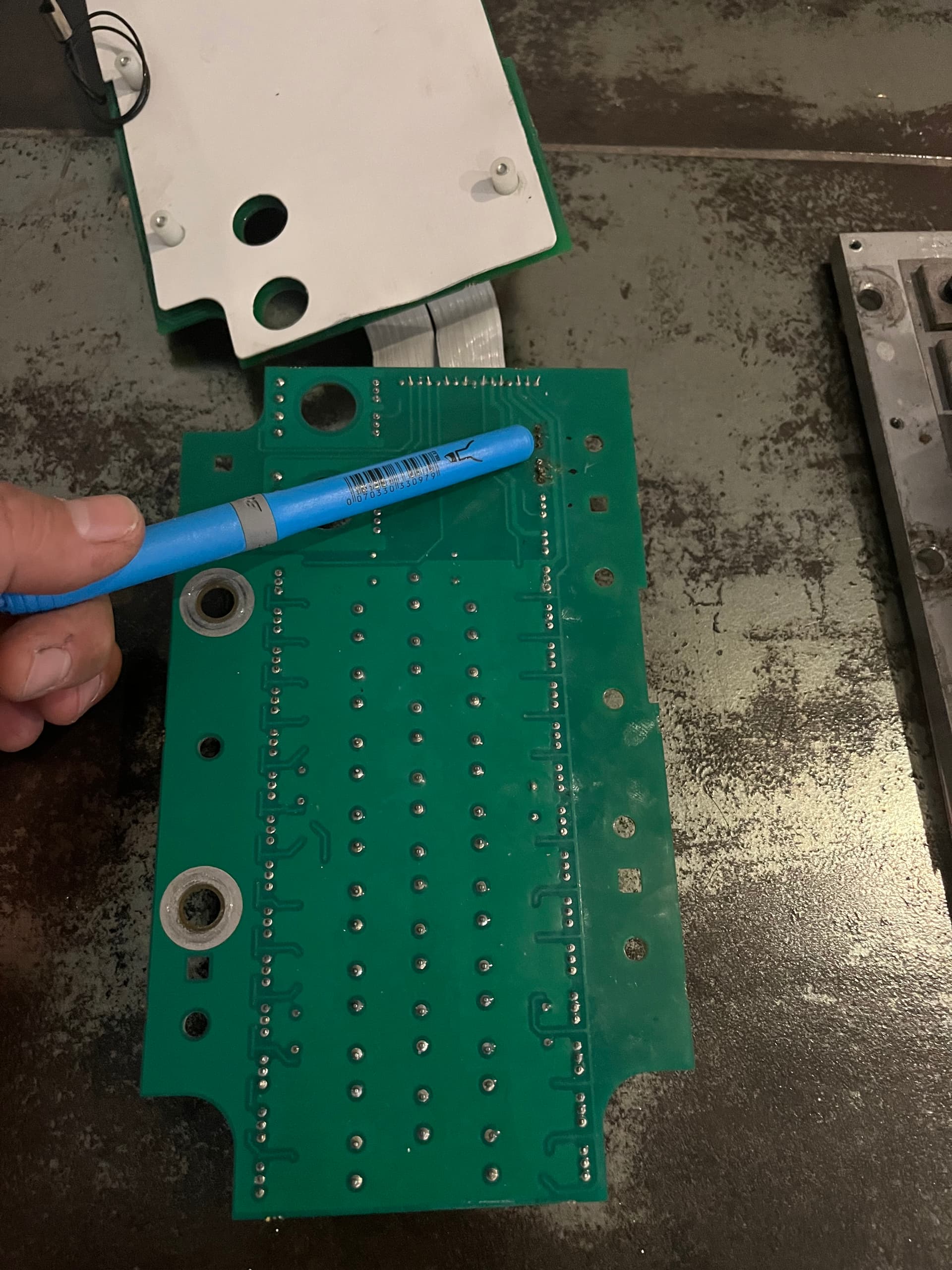

Hello guys, the error 66 persists and every time I open the controller the mosfets get burned again. Can anyone tell me where the mistake is in isolating some mosfets? I’m sure there’s something wrong in the assembly as I’ve been reading in the post. The only insulation I have is what looks brown.

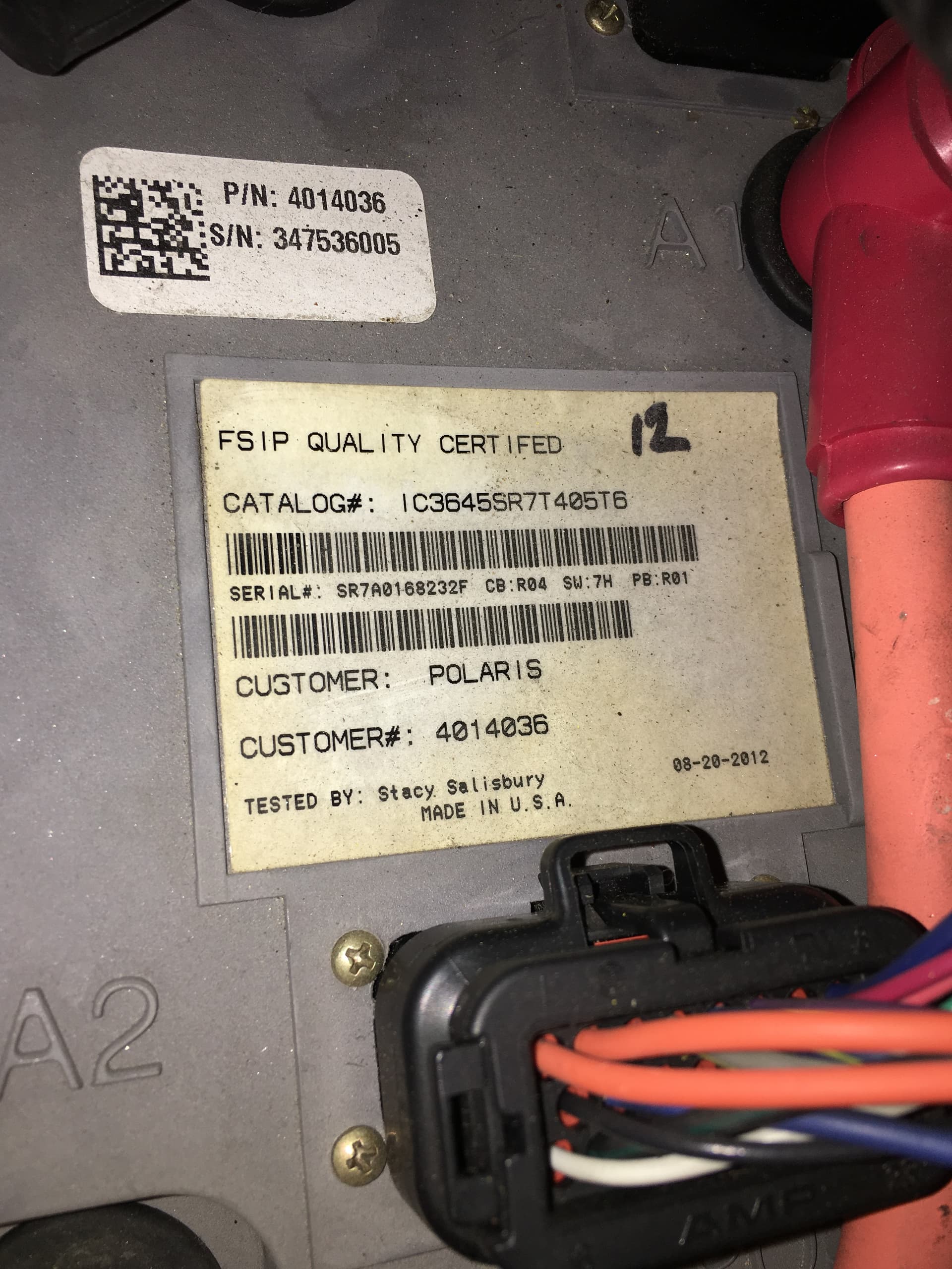

Controller is FSIP IC3645SR7T405T6 from my GEM POLARIS E4 2012"

How many FETs are blowing? Sometimes you can you tell by the grouping/arrangement.
Are you doing the repairs/swap yourself?
Maybe you are getting the incorrect or cheap parts?
What FETs are you installing? Where are they coming from?
Hello, well, you’re right. Since the last time we talked, the car has been stationary. Some time ago, I bought the mosfets on Amazon, and today I decided to change 4 of them that showed different data compared to the others. I wanted to send the controller to FSIP, but being in Spain, they didn’t accept international shipments I’m leaving a photo of the mosfets and a photo of the ones that were bad. I was looking at the post, and I’m sure they are breaking each time I change them and mount them because it seems to me that I need to isolate some more mosfets.
hi think you need P80NF12 for field mosfet ?
I don’t know but the pictures is from conreoller’s mosfetd.
Note that there may be at least 3 groupings of FETs and each may have different part numbers depending on their use.
I have never seen a T6 so I am just guessing here.
