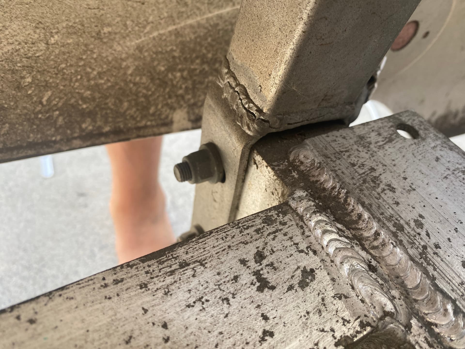

I picked up a 2016 Gem e4 5kw from a towing company lien sale for $500. It was in a rear end accident and has body damage. The frame pillar next to the rear drivers side is bent and the weld broke. Other welds in the rear box frame are broken as well.

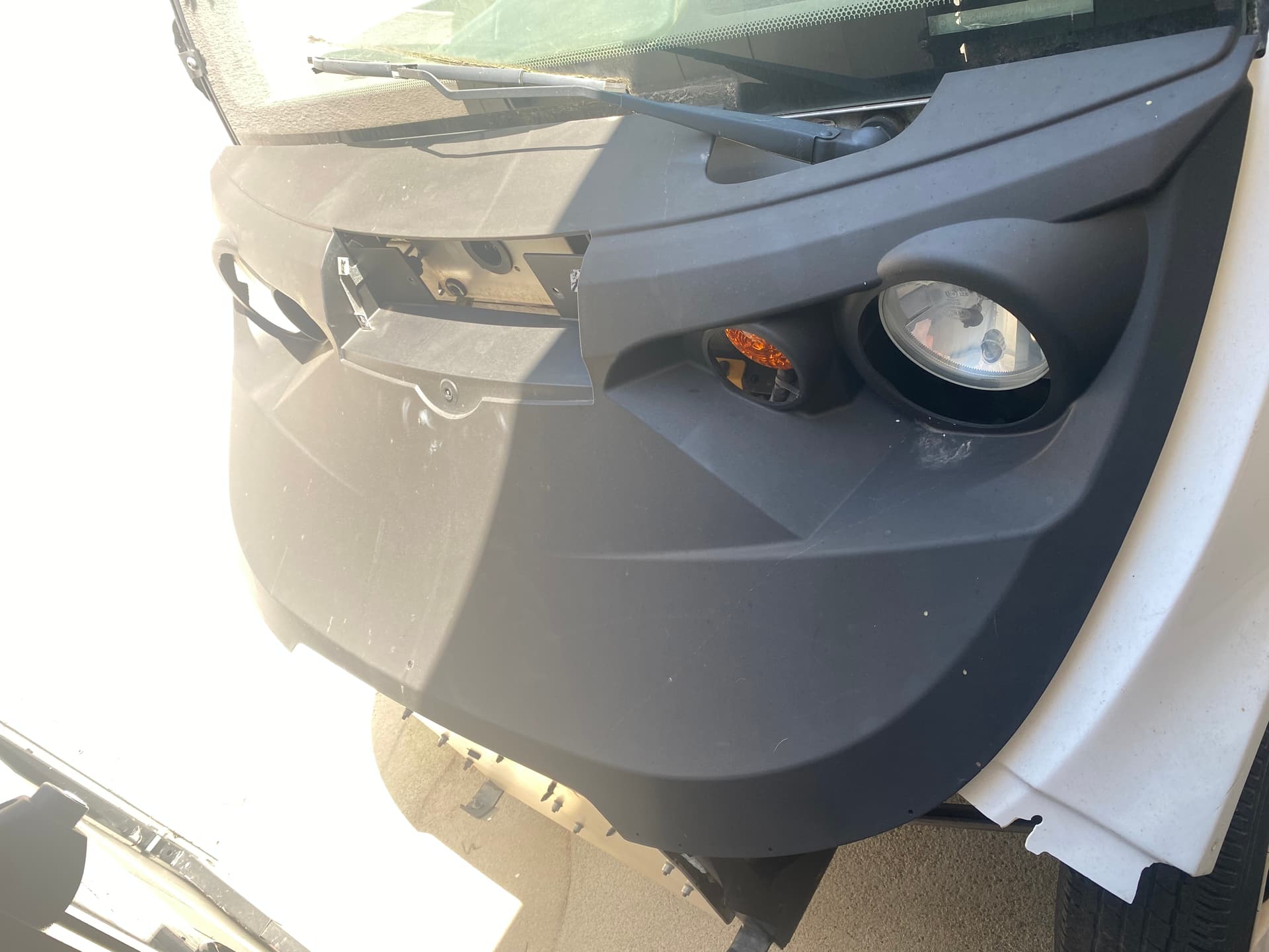

I have not tried to source body panels. (Others may jump in with their comments). I’m thinking they are fairly rare/difficult to find. Best source would be someone else parting one out. Meanwhile, You can practice the hot staple from the backside method and filler/sand what you have for now and swap out later if you fing a deal.

Scrap it for parts… No way you’ll get it back to glory for $5k. You’ll easily make your $$ plus some.

I would have pulled the trigger but getting rid of the frame and the rest of the car would probably cost more than what you paid… Or you’d have to take a sawsall to it and slowly throw it away.
Getting it running should be the easy part… I think repairing and sourcing parts for the body panels, welding the frame and making it to straight, dealing with a potentially salvage title will be the hard part.

Last I looked into the panels, they were mostly out of stock and expensive. A lot of them are glued into place and a pain to remove and install.
