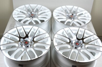

Thank you all for the posts about wheel, tire and spacer size. Below is the link to the wheels I went with. I think they look GREAT. This forum is such a great tool for ideas and information. Thank you again!!
DDR Haze 17x7 4x100/114.3 35mm Black/Polished 17" Wheels Rims
I went with the white ones but the black ones look great too!!
What size tires? Did you have use spacers?
Yes spacers, they are 17”
also went with the white/polished DDR. with 195/45/17. wanted them to tuck in a little more in the rear and be a little taller to fill in rear wheel wells. May look at lowering rear shocks some.
Good choice! :wink:
