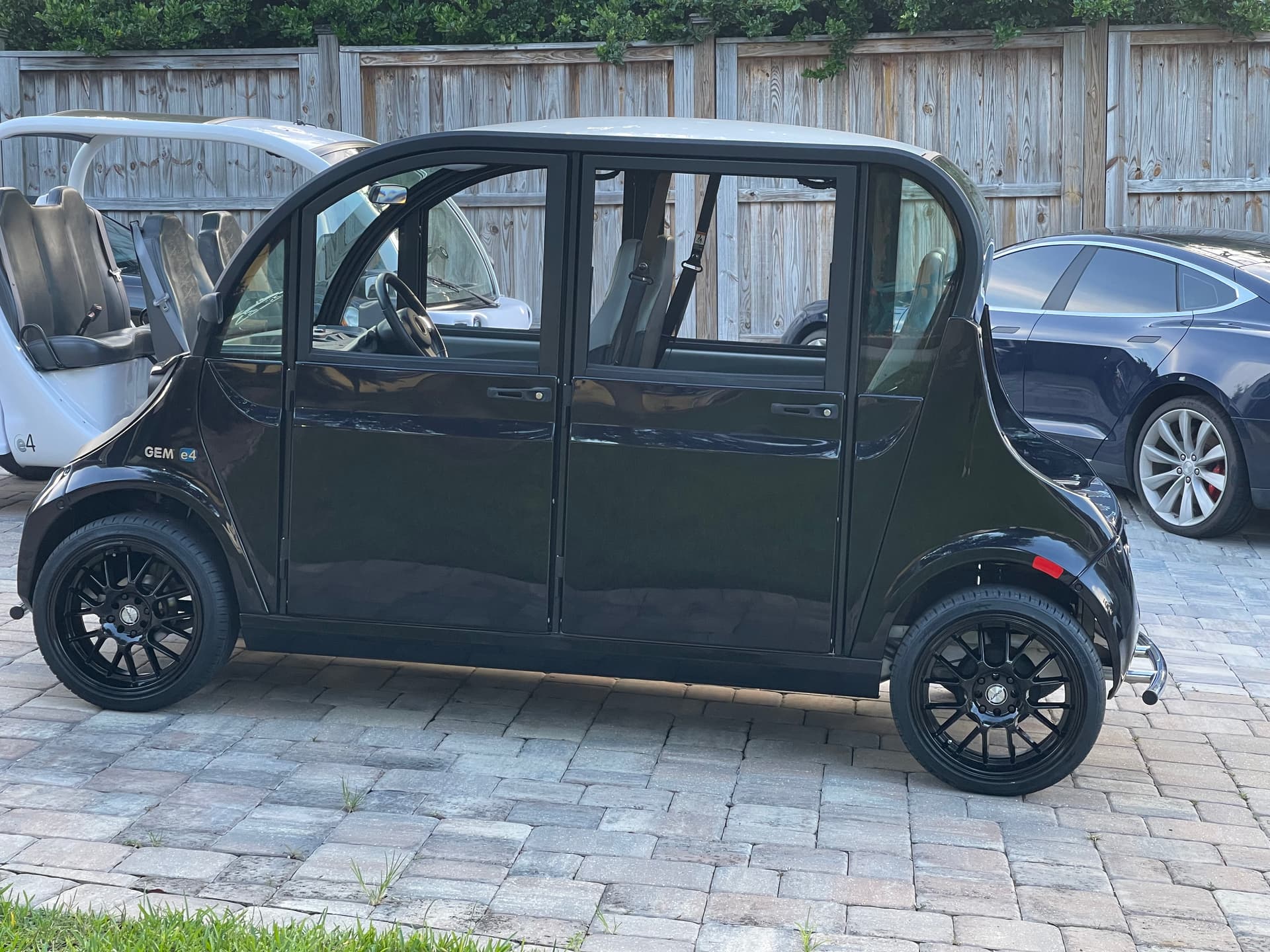

@grantwest - I think you are running a different tire size than me also (205/40/17), that makes a difference
Yup a bigger side wall tire could make all the difference. Good thing I have little to no side wall flex or we could have a contact issue
I can’t even put my finger between the rim and the shock on the front or back. - they are close.
Grant what size of tires do you have? I notice you went with a 17 x 9 rim.
I like a wider tire look. I thought 205 are pushing it.
You like me! You really like me!
I resemble that remark.
Happy day!
205/40/17 35mm offset
Using 1.5” spacers
Special nuts are needed. ( you can find them in auto parts or Amazon)
That looks great. I like those rims. What kind are those. Wonder if they have them in black ?
I ordered 1” and 1.5 “ spacers the lugs that Grant suggested.
They have it but in 15”
you can ask them if they have it in 17” black
You are going to need 2" on the back - most likely with an 8" wide tire.
Looks like you got Your wheels one
While it’s fresh in your Mind could you list all the parts you ended up using.
Hi Grant.
The rims and tire are from Grants guy. Haha
Stil do not know his name. Everything went smooth and was competitive with others.
I put on my Gem
Rims Shift Crank 4x114.3(4x4.5) 17x7.5 +30 offset
Spacers 1.5" on front (1" would have worked , wanted the wider stance)
Spacers 1.5 on back ( used 8mm adapter also)
Wanted more clearance from shock in rear.
205/40R/17 tires any brand is good.
Everything fits. Have a slight rub on front fender if I turn sharp. Nothing for me to worry about.
That’s my story ! Good luck to others.
Also another remark
The spacers come with different size lugs.
First 1.5" had 12x1.25 studs
Second set had 12x1.5 studs.
Rookie mistake.
I ordered 1" , 1,5" & 2" spacers and 3mm and 8mm adapters just in case.
Also ordered all spacers with 12x1.25 studs.
I used my old lugs to bolt spacers on. My stock stud where a lot smaller.
