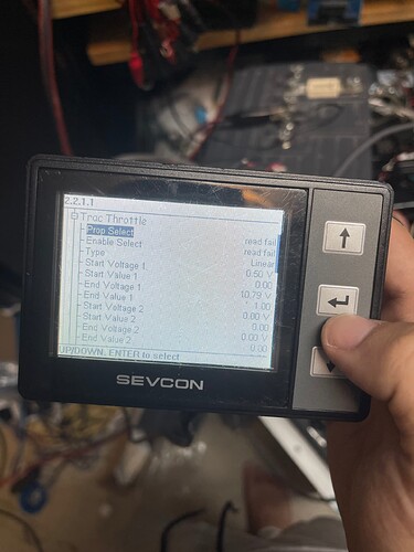

Ok I just plugged in to the S6 and it surprised me, it’s like a mini hand held DVT
It will also show the speed/battery/Gear in the main screen.
Btw, I went outside to hammer the pedal a couple times. Max current I’ve seen was 380A.
No errors so far
