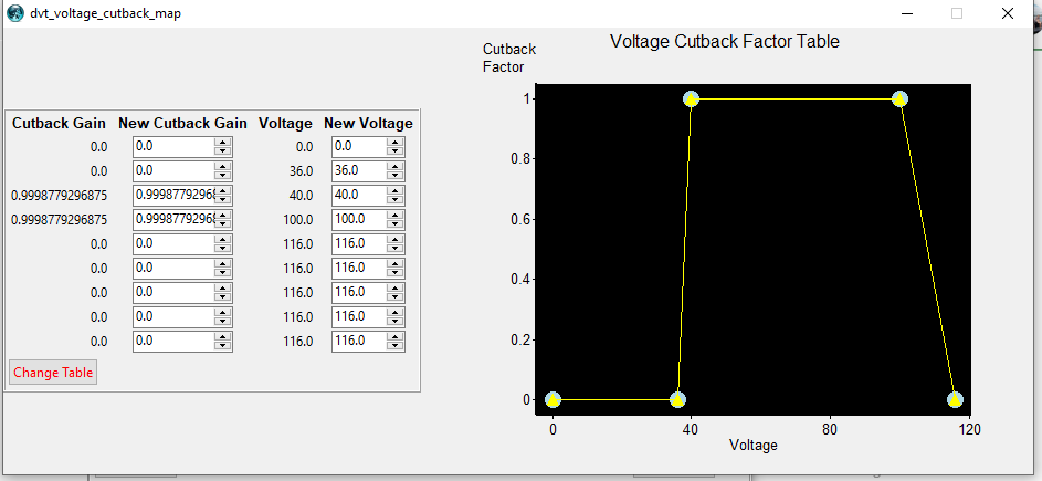

Click the big “H” top row.
then “battery limits”
baseline profile in garnt dcf
voltage cutback
Do not change anything.
Save dcf

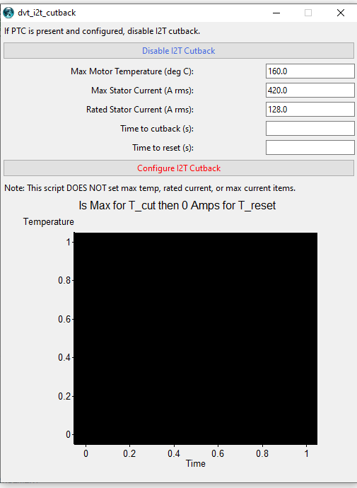

Grant may be using a S6 controller.
I would have reduced current to hw limits of S4. 350a or possibly 400a
S4=350a
