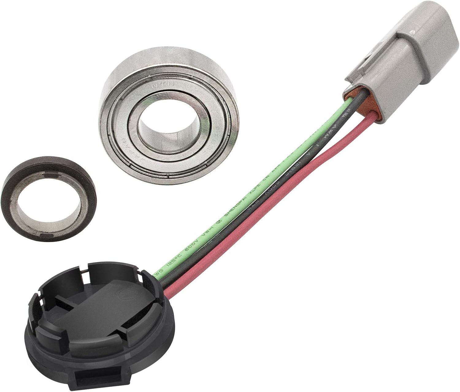

I have a 2015 GEM eS with a speedometer issue. I was getting codes 82 & 81. I replaced the speed sensor and magnet on the GE 7hp motor. The error codes went away after replacing the magnet twice. The odometer seems fine but the speedometer is not accurate. It reads about 1/2 the mph. When I put the speedometer in KM/h it appears about the same as the mph. I recently put a magic magnet on the car that I purchased from David Bissen. My max speed instantly increased to 30+ mph from the prior 26mph per my gps speedometer app. The car’s speedometer still reads the same.

I got a sensor and magnet from NEV and the magnet was marked “4 pole” and it now reads 1/2 the actual speed. Tried for several weeks to call them and always got recordings so I left messages. No return calls and now at that same # I get GEM and they don’t seem to kno

The mph & kph read roughly the same (half speed) with & without the MM on the speedometer. When the car was running before the 81 & 82 errors, the speedometer would indicate 26 mph before the governor stopped the acceleration. With the MM I have clocked 30.6 mph (gps app) before I let off the pedal. I feel that the speed magnet and/or the speed sensor have caused this problem, I hate to buy them again since the error codes have gone but I do want an accurate speedometer.
I purchased another speed sensor from Amazon. It was a Clubrally brand. It appears to have eliminated the error codes 81 & 82. I changed the speedometer from mph to kph. Now the speedometer aligns with the gps app on my phone.
