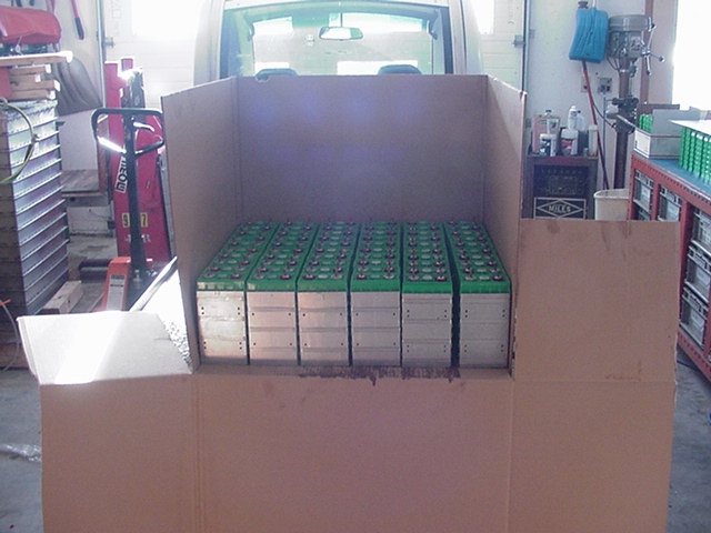

3’ x 3’ x 16" pallet.
6 x 10s modules
end plates
Copper flex bars
Nuts for studs
6 x 10s modules
end plates
Copper flex bars
Nuts for studs

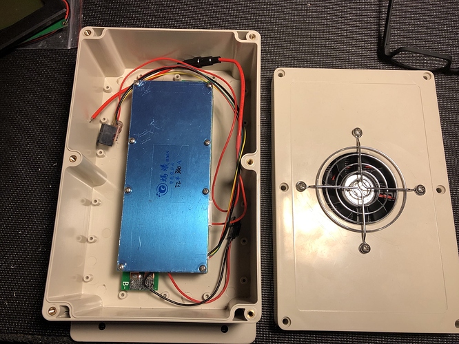

The bms has power mosfets that the charger connects to.
Bms will turn on and off as needed.
B- on bms connects to B-
C- connects to charger black wire. (neg)
Charger red connects to B+.

Do I need a switch for the red arrow?
Comes with it. mom.
I generally just short the pins if needed.
Also a switch on display that can wake up or reset bms. I leave a hole in box for pencil eraser to access switches.
Both power and data are wired thru RJ connectors on yours.

Excellent, Ill figure it all out once its all in my hands. Project boxes got here today and I was planning on putting the power switch for the bms on the outside of the box but if its only a momentary to wake and the display has the same function its not even needed.
Just got the BMS box…first impression…what did I get myself into. Second look, not that bad.
I believe that I did a lot of the work for you, no?

The four temp sensors, I’m guessing place them in thermal paste on the top?
I never use them.
