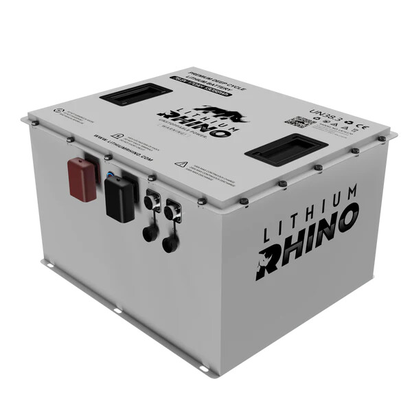

I found the width and depth, but how tall is the question. I’m considering the Rhino 76vX170ah
unit. It is 18 inches tall.

I think you will have trouble attempting to fit that 170ah battery. There is not enough free space to fit a cube battery with these dimensions into a Gem.
Your battery:
  • Length: 21 inches
  • Width: 17.9 inches
  • Height: 12.6 inches
The car:
The 08 e2/e4 short bed have the same basic battery layout
4 lengthwise across under rear seat, then 2 more on a tray sticking out under the rear fender/spat. I believe the e6 has the same frame dimensions, but the batteries are laid out a bit different.
  • The 4 across under the rear seat are split up as 2 in a center well and 2 outboard wing batteries because of a diagonal frame support for the back wall and rear bed support.
  • Top height is limited due to the cross brace for the seat.
  • The center and rear battery wells are separated by the frame cross brace.

I thought I’d point out that not only does that battery have an issue with height, but (according to my quick measure skills), this battery won’t fit anywhere lengthwise or even width.
