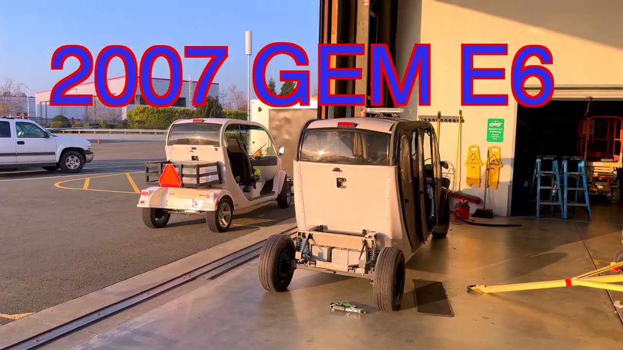

I know i’m eight years late… but here is what I found while working on my 2007 GEM E6.
The voltages on my gem were all over the place, 74 volts at the 6 - 12 volt batteries, 69 to 70 volts at the PSDM, the previous owner said “THE BATTERIES DON’T LAST & THE CAR IS ALWAYS SLOW’ OK here is the answer…. Check under the middle set of seats, there may be factory installed batteries under the center seats. The three 8 volt batteries I found under the seat were hooked up between the 6 batteries in the rear tray and the PSDM, two were dead shorts and one was a 1/2 volt, they were messing with the voltage & causing the batteries to die & they were in there for 18 years !
That’s some funny shyt.
So no one noticed that 6 x 8volt = 48 volts and not 72 volts as advertised?
Math is hard. And apparently RTFMing is even harder
My guess is that whoever had it, removed the Six 8 volt batteries from the rear tray & sold the car…. The next guy seeing no batteries put in 72 volts worth of batteries and the trouble started there…
It took me a day & 1/2 to figure it out because the extra batteries were reducing the voltage.
