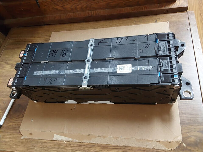

I do have some 110ah 6s EV batteries for cheap. Left over from another project. 4 of them would make a nice high voltage battery. 84v nominal. 96v max.
Needs mid-skill level to mount and connect in series, but result should be great performance.

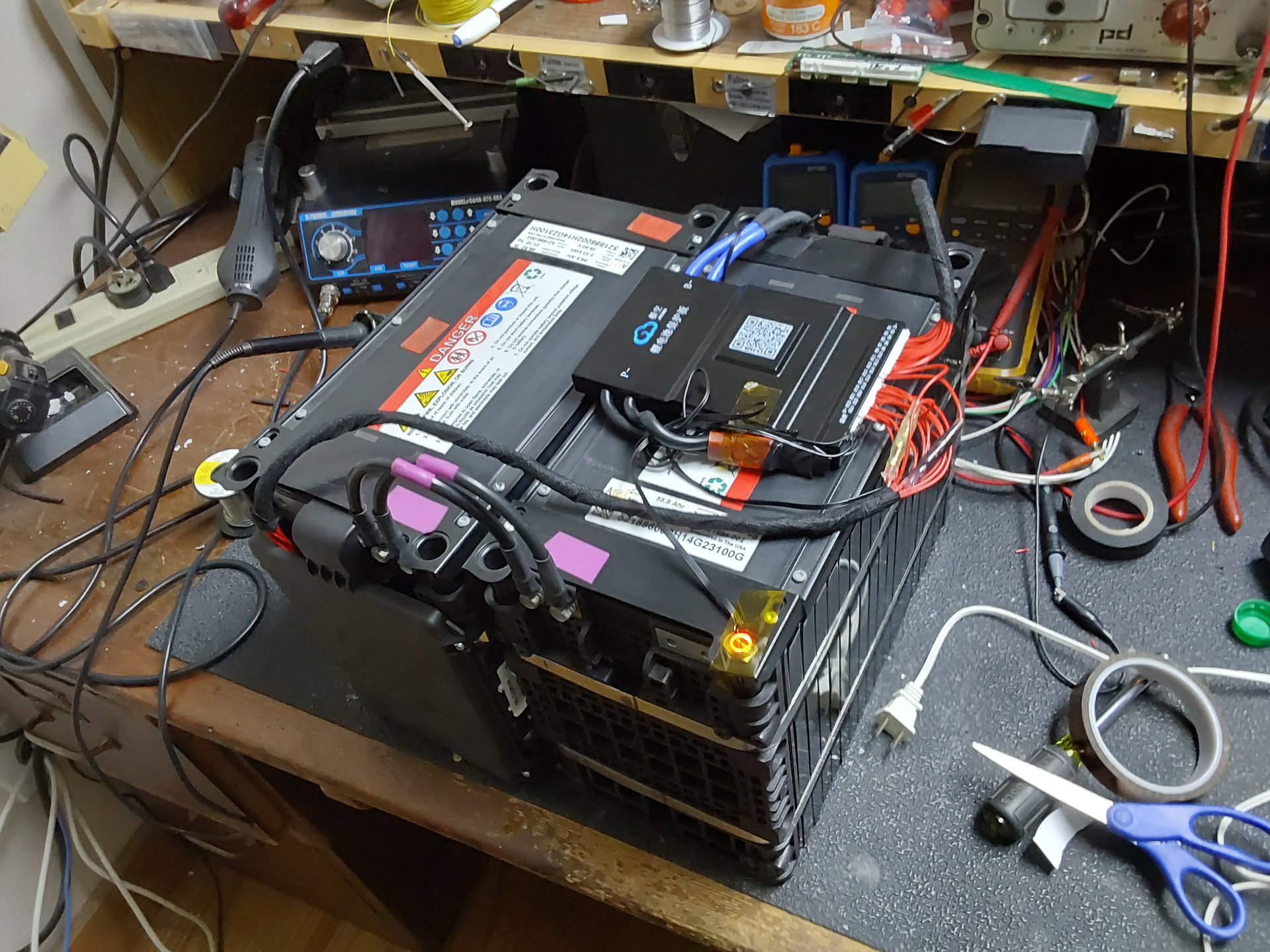

The only wiring I need to do is put plugs on them for plug and play bms.
The 4 modules just connect in series like oem 6 12v batteries. These are 4 x 18v. All are on one bluetooth bms, so disregard our panning those using 6x12v batteries in series.
Picture was before wire management. Shows 2x2 layout, but they may be moved around or even stacked. I bolted them to a piece of osb the size of Tesla battery, above, that it replaced, and slid it in in one piece.
This is 9kwh for when you compare prices.

Ships in two pieces with violet series connection removed and small red bms wires unplugged.
risky in a 2002. They have T2 controllers. Some wont play nice with 96v and will need a Deltaq charger. MM is a better battery for a 2002
Yes, the mm is available for @Bigeric619 2002. I should have broken off the other inquiries, but having trouble.
Fitment in a 2002 may also be a problem for the big modules.. 4 pieces.
