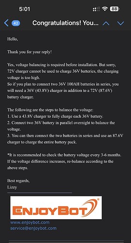

These are the Enjoybot 36v new gen batteries.
Directly from the manual included with the batteries. And also confirmed with tech support via email.
I did ask first, the manufacturer (Enjoybot) tech support direct. I don’t know where that quote you got came from. Plus it’s in the manual. See below.

I saw it on the enjoybot web site.. INWO was right to bring it up. Most wont let you series two 36v or 48v batteries. from their web site this is the manual I saw..

I honestly didn’t even know the older batteries were still on their site. Otherwise I would have led with the new specs. That’s why I was confused and said I didn’t know where the quote came from. Re: “No series connection”.
I never even went to the 36v section, only 72v section which only shows the newer 200amp bms model in a package. Looking at the 36v section now, I see there is both the old and the new 200amp models.
