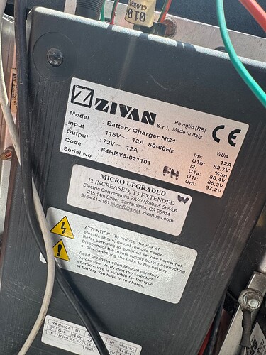

Gem e825 zivian ng1 I2 increased T3 extended
Hello, just recently traded an e-bike for a Gem 2002 car. Seems that one of the previous owners did well with maintenance and upgrading everything with the recalls and stuff that I can see. One of them is the charger it says on there it has been micro upgraded I2 increased and T3 extended. My question is can I just plug n play with this charger being that I’m upgrading to lithium batteries (36v x2). Or should I just grab a newer charger? I’m going with the Enjoybot Bluetooth batteries 100ah. Getting them to fit is going to be fun but that’s part of the fun for me customizing crap. That is the sticker on the charger. I ordered another charger I’m just curious if I can use the stock charger I’ll just return the one I ordered and put that $ somewhere else into the car. Thanks in advance, btw I’ve searched and I can’t find a straight answer, before the flames come out. Hopefully these boards aren’t like that.

My two cents, is get another charger. My 2002 came with an external charger from the previous owner(s). I have a Lester Summit II on my Club car that I’m converting to Lithium. It should work fine with Lithium. And, the GEM has a Delta Q charger. It has an Anderson Plug on the dash to plug into. The old charger is still in it, but I’m certain it doesn’t work and I haven’t attempted to remove it. No reason to while the cart is working. If my Club Car lithium build goes well, I’ll probably build some for the GEM. I’ll probably have a case made by Alibaba so it will fit better. I had one made for the CC. I just don’t have the tools anymore to build my on and it really wasn’t very expensive.
I had already ordered the 36v (for initial setup and occasional balancing) and 72v chargers ahead. And I was anticipating the response would be, from most, to get a purpose built charger as opposed to the zivian. I just wanted reassurance from some of you more knowledgeable people.

You wont need that charger assembly anymore. It it really just crap and fails often. I would instead use the empty space there to install other accessories, or another charger that will support lithium charging. This charger tends to short out and cause fires. In addition, since these are made for lead acid, the voltage it varies and can cause overheating to lithium. Lithium chargers tend to start off on a lower voltage and creeps up to a target voltage that will allow it to fully charge to over 72v.
Roger that! I’m gonna remove it today. I think I’m just gonna keep the new charger outboard but still use the existing charging port near the seat. I balanced the batteries already and installed them. Working on all the wiring and stuff now for the rest of the cart, lights, 12v outlets, audio and accessories. I have a solid state digital switch panel going in I’m gonna keep the brain under the seat so it’s easier to access as opposed having to pull the dash if need to do some maintenance or trouble shooting.

I get that. But have you seen the design of the zivan charger? All of the openings and gaps allow dust, moisture, and bugs to get inside and create shorts. Similar to the PWB recall. One of the e825s I have originally caught on fire at the charger. I believe it’s one of the reasons why they went the delta q route because that unit is tightly sealed.
A lot sample of one does not make a majority (“prone to”) as your assertion claims.
I’ve been to the sole us distributor of the zivan chargers and spent hours talking with him. You are not alone in thinking that there is a restriction in the ventilation on the charger, as he would add extra vent holes.
We also discussed the charge curves a bit. Pretty interesting. Lot of possibilities there. Some Zivans are more capable than others. Some have 3 modes, some have 8+. Its not quite the one trick pony it replaced.
