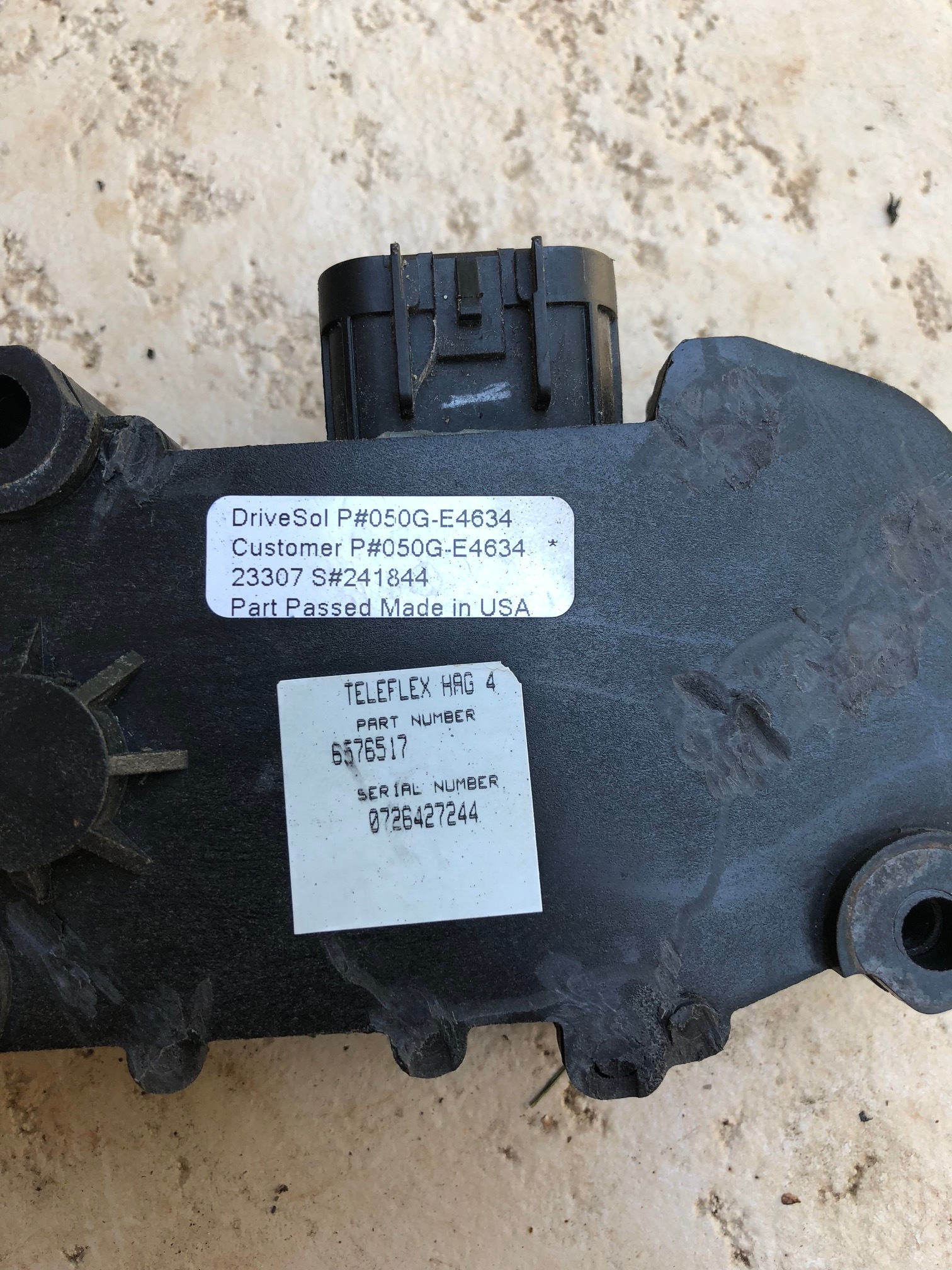

I had the same issue with the same symptoms you are experiencing. You can see an earlier thread on my battle to resolve. Inwo and old Houseboater were a huge help. It was the throttle control. Sounds silly but unplug your throttle control at the connection in the engine area and reseat the plug. Pothole jar may have loosened the connection. If that does not do it, you can do what I did and dremel off the rivets and clean the contact points. I also reheateed my solder points to reseat them as well. It acts like a servo and over time can get gummed up giving bad connection. Reattach the plate. I used a velco strap and silicone to reseal the assembly. Running fine since. I agree, hard to find part. Dealer say back ordered, but can cost $450-$550 for the assembly. See pics… Hope that helps.
