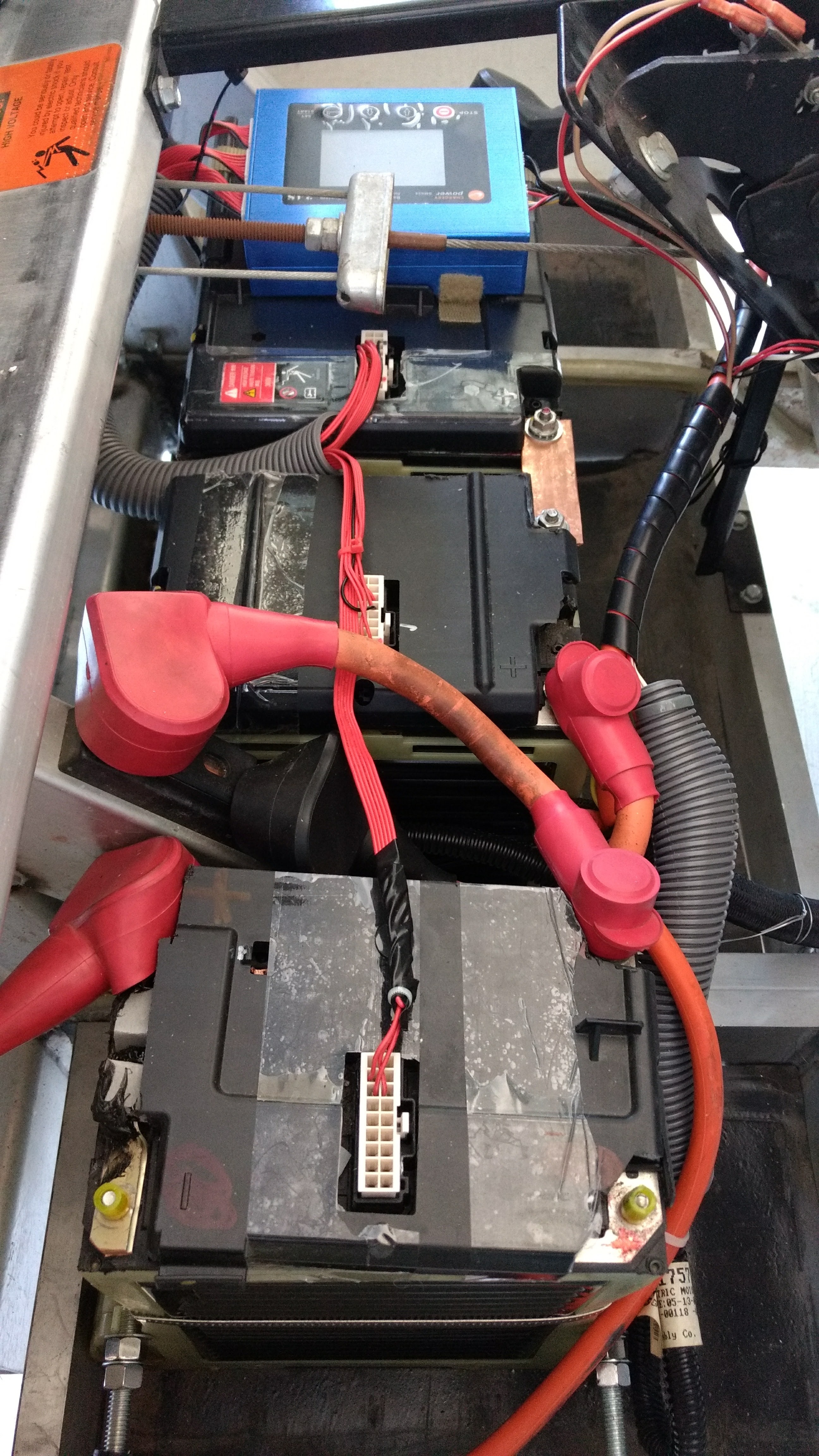

Let me start by saying I’m a mechanical guy, not electrical, but I am comfortable with a VOM and solder. Because of this I decided to get David’s package from the Buy, Sell & Trade section of this forum instead of some commercially available packs. Having followed conversions here for several months I knew there was lots of help available here if I needed it.
I call it a “package” because all I had to buy was hardware to mount it. After wrestling the first gel out by hand I rigged a block and tackle to the roof for the rest of them, one hand to lift and one to guide it out of the hole. After considering several mounting options I went with 3/8" threaded steel rods. Because of the shape of the Volt packs the rods fit nicely in the clips above the cooling chambers, front and back. Rods are attached to the frame on both sides and fender washers with locked nuts on each side of the packs stop side to side movement.
Because David’s BMS is PNP, and with his guidance, electrical was no problem - NO SMOKE. Charged with reprogrammed DQ and time for test run.
The farthest I can legally drive on roads is about 10 miles. Two 10 mile trips, with a charge in between, bumping against the speed limiter each run used about 40% of the pack. Because of the diet I put the car on (lost about 1/3 of it’s total weight) it is quicker (spin the 70 series tires), slightly bouncier ride and sits 3/4" higher. I’m still tweaking BMS parameters and need to clean up the rat’s nest of wires under the seat - I was more interested in running it than making it pretty.

BMS is temporarily attached to mat for easy access while I play with settings. Will eventually be mounted under seat.
Looks good.
I mounted mine to center brace.
Under and inside the angle. 2 holes drilled and a strap clamping it tight. Rubber straps protecting bms.
I guess it could be mounted to battery cover also.
Looks good. Not as tight as I thought it might be.

The one I have left is a little different in that the two small ones are in on package. Rather that three it’s two of the larger ones pictured. Electrically the same.
Craig can tell you if he thinks it would fit the same way. It should
Ok, as long as I can make it clear the emergency brake mechanism. In the forum you mentioned you finally got yours on the road. How does the Volt battery pack range compare to the Leaf pack, about the same?
                    Russ
Just took some measurements and I don’t think 2 large packs will fit in the center tray unless you cut off the cooling chambers and rotate them 90 degrees - front to back not side to side. I didn’t have to remove the parking brake to get it in, but if you pull 3 bolts the whole assembly can be moved off to the side if needed.
It would be easy to cover the passenger side battery pocket and mount one pack on top of the cover. Gives easy access to tie into fuse.
Been thinking of mounting to the top of big pack with velcro and a tie wrap
around the wires for a backup.

I finally got the wiring dressed up and BMS tweaked and mounted to top of battery with velcro. Project finished, 'til I find something else to tweak.
