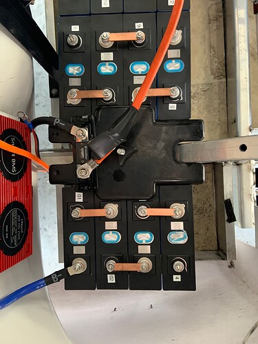

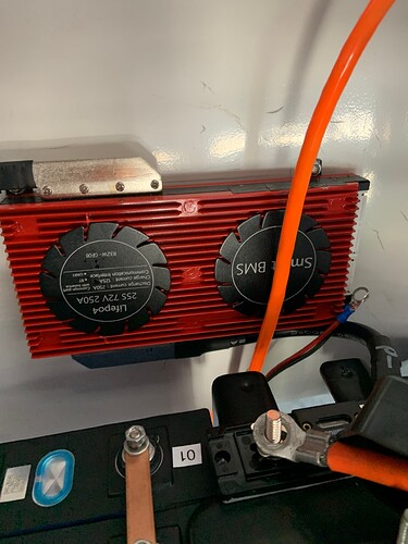

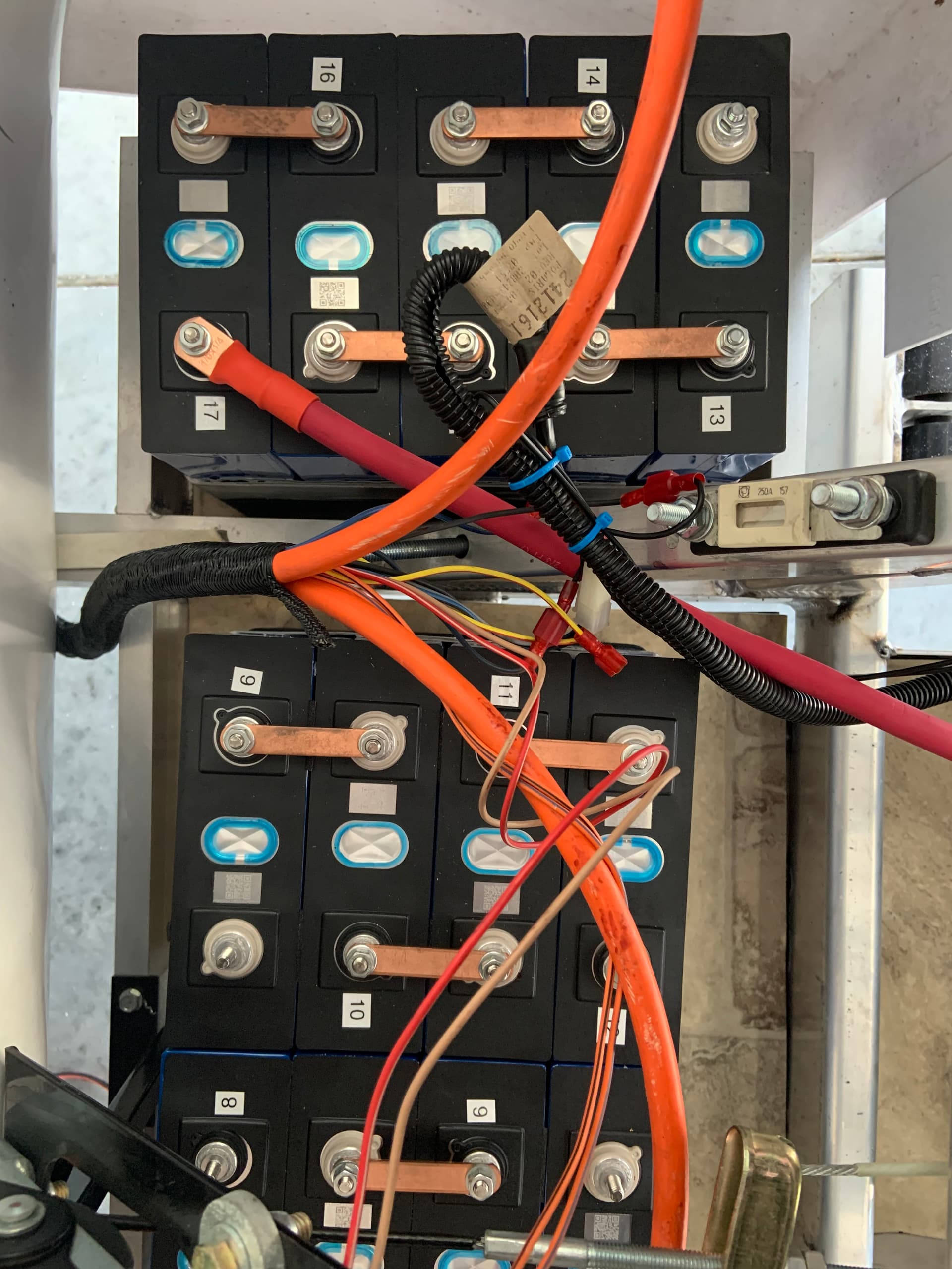

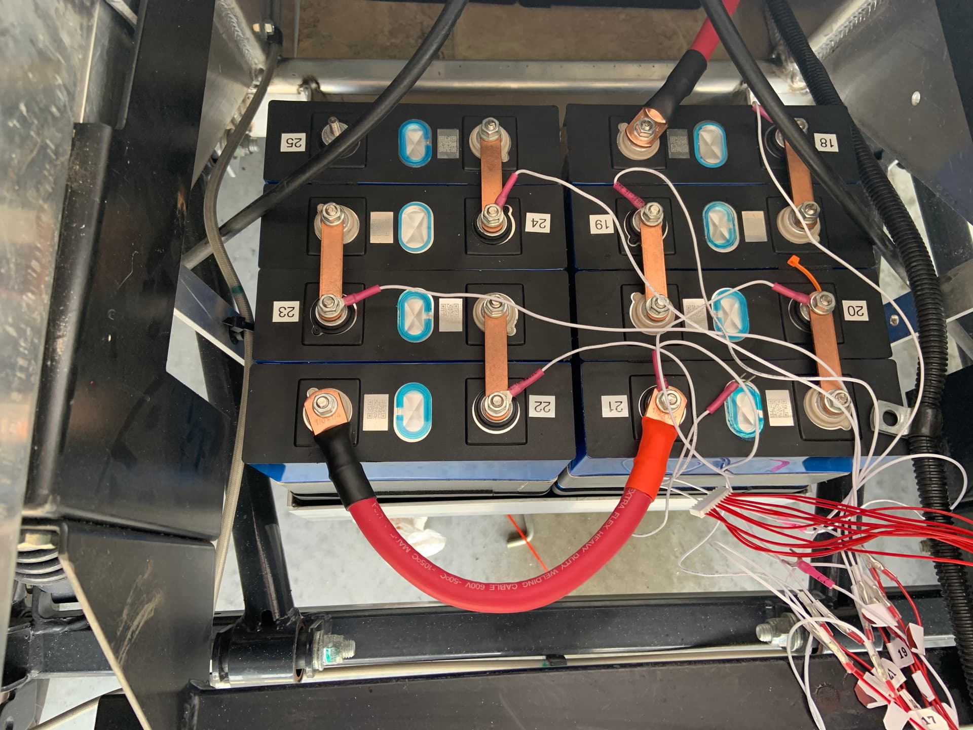

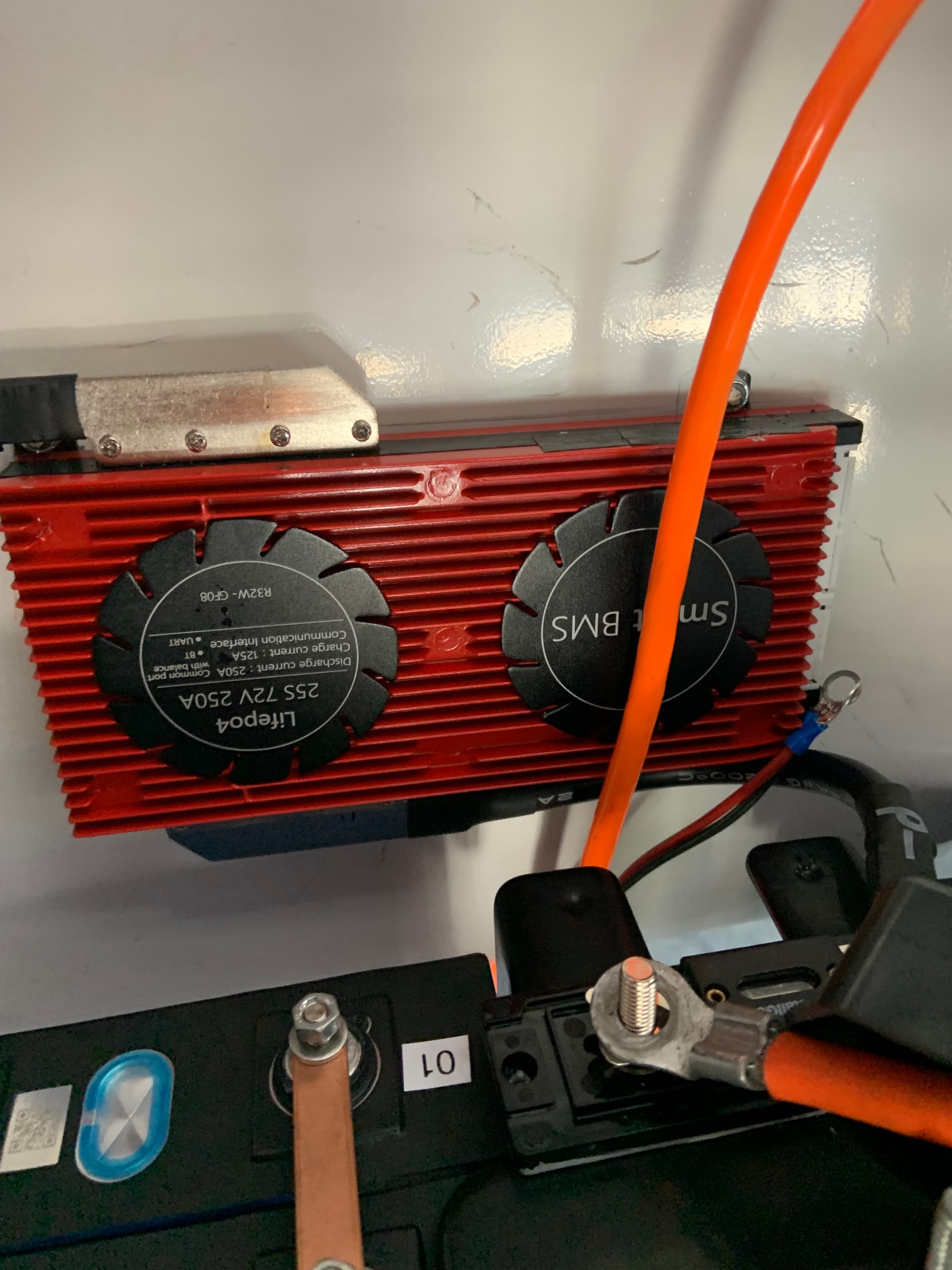

First reply put in a picture that I did not see. I have cleaned up the install since these pictures were taken. Some off the original power wiring show but is not connected. The new wires are 1.0 red and black. They sure do seem like they make a big difference. Every large power wire was changed from the batteries to the motor. As you can see the last pack on the right side has 5 cells and all the rest have four
