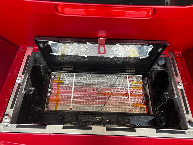

Finishing up this Beauty, 2022 E4
The owner wanted to be able to go faster and Drive farther so after talking about his idea and explaining him the available options he decided to go all in.
-Tesla Model X Battery 18s (66v nominal) with Bluetooth BMS.
-Controller Swap with Our Custom Firmware.
-35mph with Stock 5kW motor and Stock gears.
-J1772 Input for public EV charging stations.
- AND… wait for it, wait for it…. Turf mode!!!
Turf mode: I’ve installed a Switch inside the glovebox so it can be “locked” and limited to 25mph.
Acceleration, regen braking and max speed can also be customized.
@Inwo and myself been working very hard on this and I’m very happy with the results so far.

@djgabriel2004 what did you do with the dc/dc converter? The stock one is rated for 60v max, did you replace it or will it handle the higher voltage?
Yes it needs to be replaced, easy
I have a new one on order.
