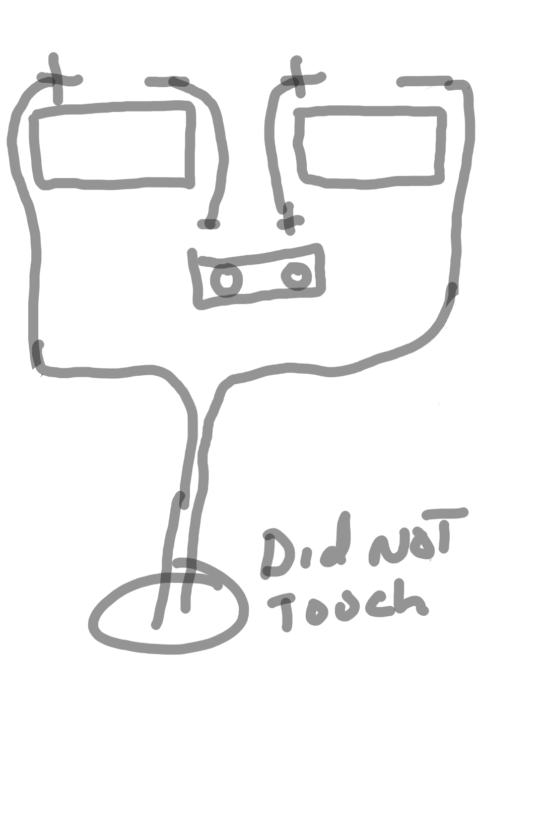

What is pictured between modules? Nothing good can come of that. Is someone helping you with this?
98v will destroy this setup if less than 24s. 88 volts.
Breaking any series connection with a fuse or switch will burn bms.
I strongly recommend that you cut your losses, unless you get good tech support.
From the small amount of information coming out, it will be a long process.
In the center of the picture is the fuse, lol that was the only part set up from the old owner. As far as cut losses scrap the battery system buy new batteries or scrap with GEM?
Keep the car and put in a new set of batteries.

The batteries sat when they came in one tested at 46v the other tested at 33v. When I had time to put them in I tested out of the car in series 75v. the 36v is modified. pictures in bottom.
75v in series hookup, Drawn picture below.
