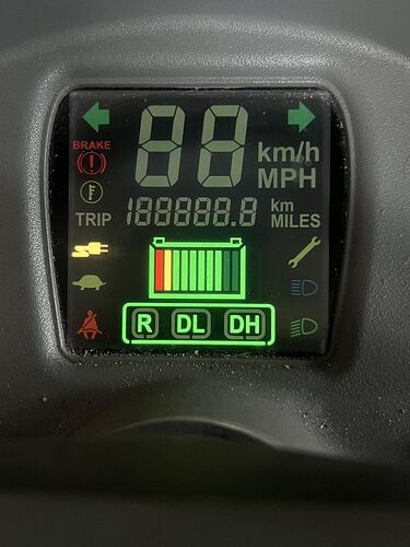

The battery on mine also always is on 1 red bar even when I charge all day and it will drive for quite a long time. I have Deka gel batteries. Any posts you can refer me to? As I’m looking here I see you’re the man with all the answers

Battery bars -
This is difficult to guess without exploring your charging system a bit more. The State of Charge bars on your dash need two things to happen to count back up.
  1. The interlock needs to be set when charging.
  2. The charge current must be placed on the correct side of the shunt(current register) for it to see the current flow when charging.
Q1. What charger is installed in this car?
Verify that it is wired into this car correctly.
  • When plugged in to charge, Verify that it is truly charging via the CHARGER display. Normally, this is viewed from the driver side if you look over the top of the tire and past the shock/spring. It is mounted under the shelf the motor controller rests on.
  • When plugged in to charge, a partial dash will light up, the interlock light should appear on the dash(small yellow plug), and the car should NOT drive.
  • the battery bars might animate in a little chase pattern. (depending on what software is flashed in the display)
