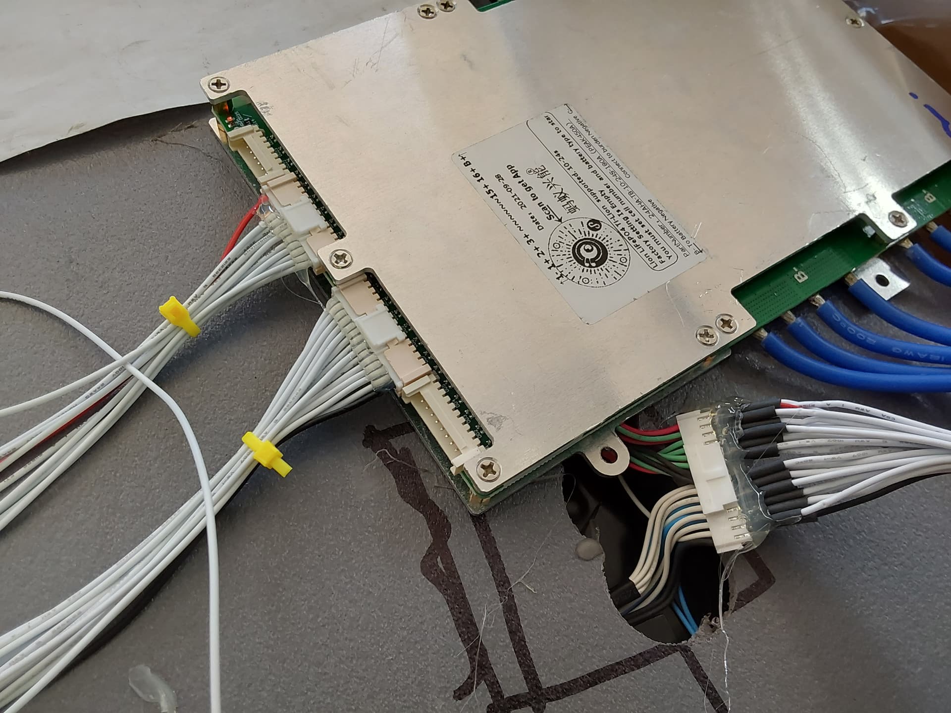

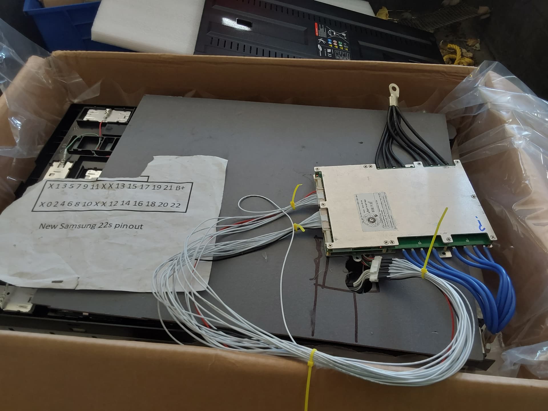

@LithiumGods strain relief loop. Out in and out again.

S4 420a peak - S6 650a peak now
18s 66v Volt- 22s 80v SDI now
Programmed in the dark - Gabe’s matching DLD/DCF now
