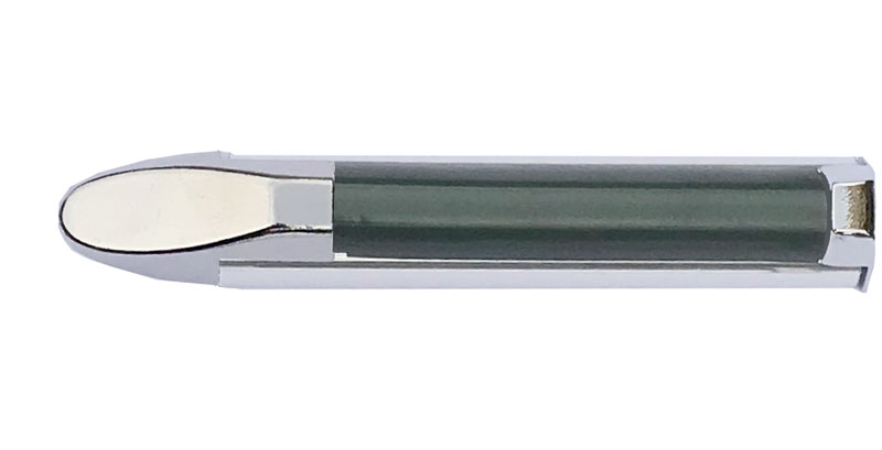

You know you got me thinking. All you would need is some sort of automotive molding, pretty much any square style molding would work. I think back to the old body shop days where we would install a aluminum track down the side of the car and pop rivit it on. The Aluminum track would hold a colored molding of your choice. They had molding in pretty much every color. I know the gem is a curved surface but you can bend and shape the Aluminum very easy. Might be a good alternative? The factory Gem one is pretty hideous. Most of them are installed all crooked and look like hell.
Rivet-on might be a lifetime commitment I’m not ready to take… :slight_smile:
I’m sure if you bent up right you could use some 3M double-sided automotive trim tape to secure it. That stuff when it’s done right holds like Tarzan’s grip I actually think it would look pretty cool if you did a nice job it would be much more legit than what Gem offers
I also saw some color matching half round body molding that would work as a drip rail
