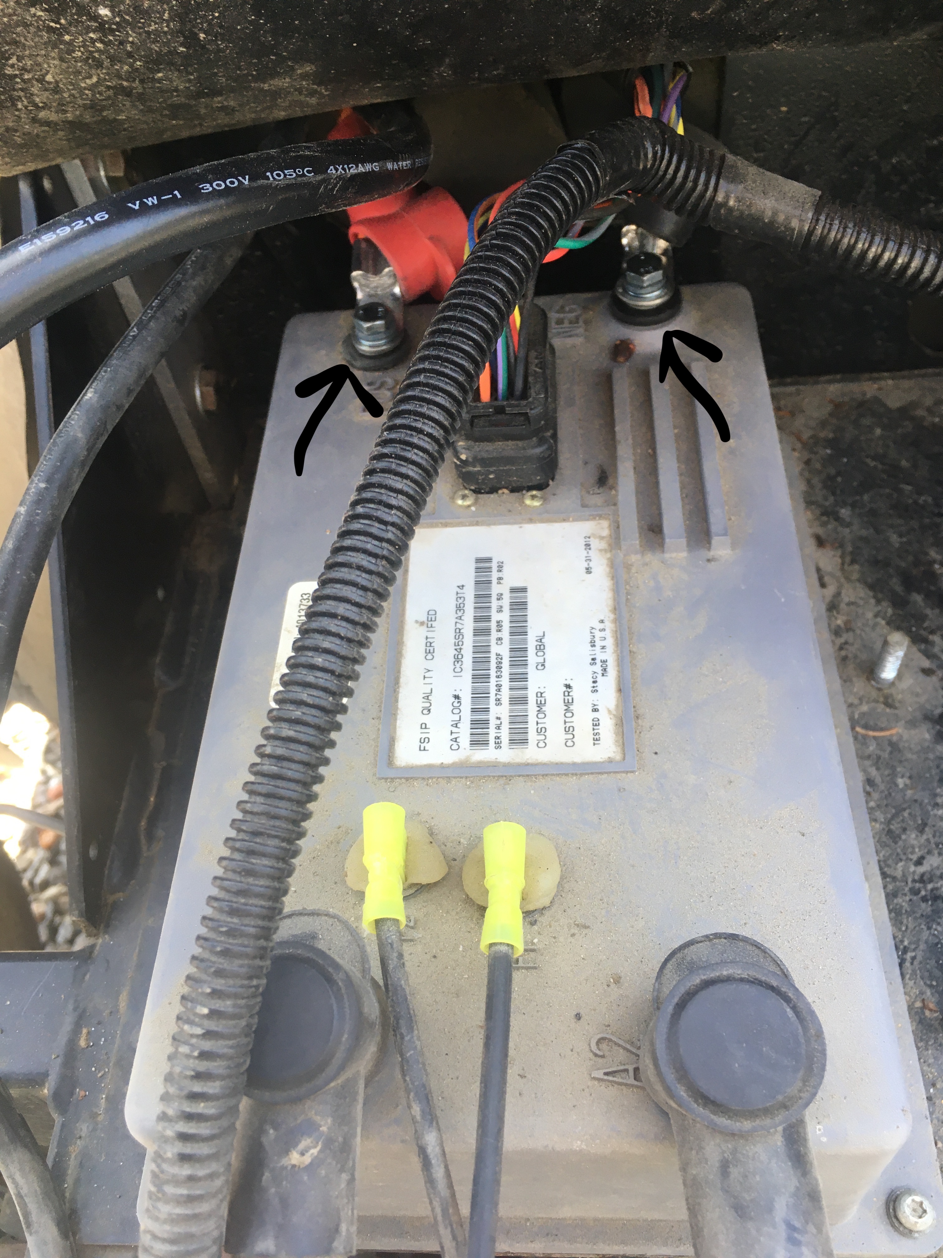

2012 Gem e4. Bought this from a friend who’s owned several GEMs over the years and before he sold it, he asked if I wanted to only use AGM batteries or buy a new charger and use deep cycle batteries. He told me that he called around and this GEM’s charger couldn’t be re-programmed for deep cycle batteries. I was told that the old charger can’t be disconnected because the controller runs through it. I now have a new Delta Q charger mounted but am not sure how to hook up the wires coming from this new charger. I’ve attached a picture of my controller - the current (old) charger is mounted underneath and as mentioned, I won’t be removing it. Any help would be greatly appreciated !

Neg does go to contoller , Pos goes to a stud under the lower inside cowling . From there it goes to the back of the black box under the dash . I always move the charger wire from the stud to the back of the box so that if i have to go in there again I don’t have to remove the lower panel only the upper .

Also posting pictures of what you have helps a lot to give you guidance .

Thanks again - the positive wire was the one I had no idea where to connect it to.
