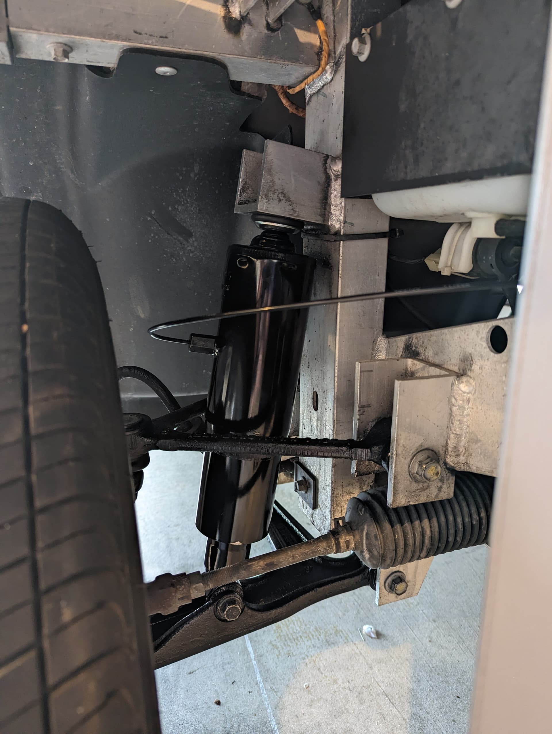

How did you install the shocks? Did you unbolt the lower control arm to get the shocks installed?
If so, did you tighten the 2 bolts too much, and not follow torque specs, causing the control arms not to move freely?

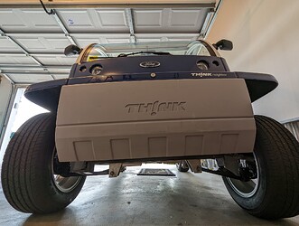

Also, looking at your picks, my shocks are a lot more open than what yours show. Is it possible that your shocks are too tall?
Thinking about this more it makes perfect sense. The air pressure is still the same in both shocks, it just shifted air volume over to the other side. There is no other force telling it to level out except for a little bit of rear spring, but that is also fighting itself. It really looks like your shocks are too long.

@Mrbig - If you put a jack under your car, how high does the frame lift before the wheels come off the ground?

@AssyRequired my frame lifts the same way it did, when I had the stock shocks installed. But when my shocks are pumped up to where they need to be, I have a lot more reveal at the bottom of the shocks, than what @C4202K2’s pics show. I just looked and the outer housing is 5 to 6" from the bottom.

Something is not right here - Sure, there is a bit of geometry in suspension design and where you are placing the spring package, But it looks like they are mounted fairly close to straight up and outboard to the wheel. According to the specs I find the curb weight of the car is around 1400 pounds.

This attached pic shows how it looks pumped up when driving it. I usually start out higher by about 2 inches to accommodate for the added passenger weight.
