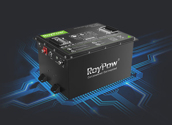

Its been a while since I tried upgrading my batteries to Lipo. Last time, I brought the wrong battery (100A 10 second draw shutoff BMS) so I repurposed that battery for.a backup on my shed. This time I want to buy the correct rated batteries. I am between the royow S51160P and S51160P. The differences is 100A vrs 160A continuous with 200A vrs 315A max discharge. When I was testing the original battery it cut off at 105A draw, so I dont know what the actual full max is for these carts. Can someone advise me on if I need the more expensive performance model since they are both golf cart rated. (Or suggest a better alternative for Lipo that fits so well in the compartment). Thanks in advance!

Neither will be acceptable for a gem car unless (maybe) you plan on only using it in turf mode. Gem’s will consistently pull 200+ amps when using on the road.
I would think 300 A would be a safe number to shoot for. I have an amp meter on my hot rod Gem that’s 98 V with an 8 kW motor and that thing can pull 400 A no problem.
Oem 2016 can peak over 400 amps.
