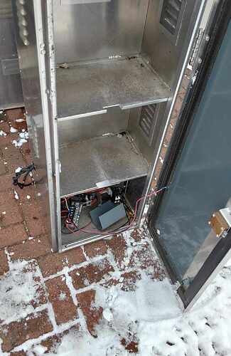

As received:
Access to lots of the aluminum enclosures, but most were stripped clean before going to recycler.
Ps. An empty one is in my way. It could find it’s way to Ca. tomorrow.
Raintight with vents and nice locking hinged door. It would actually make a nice battery box for sdi cells.
