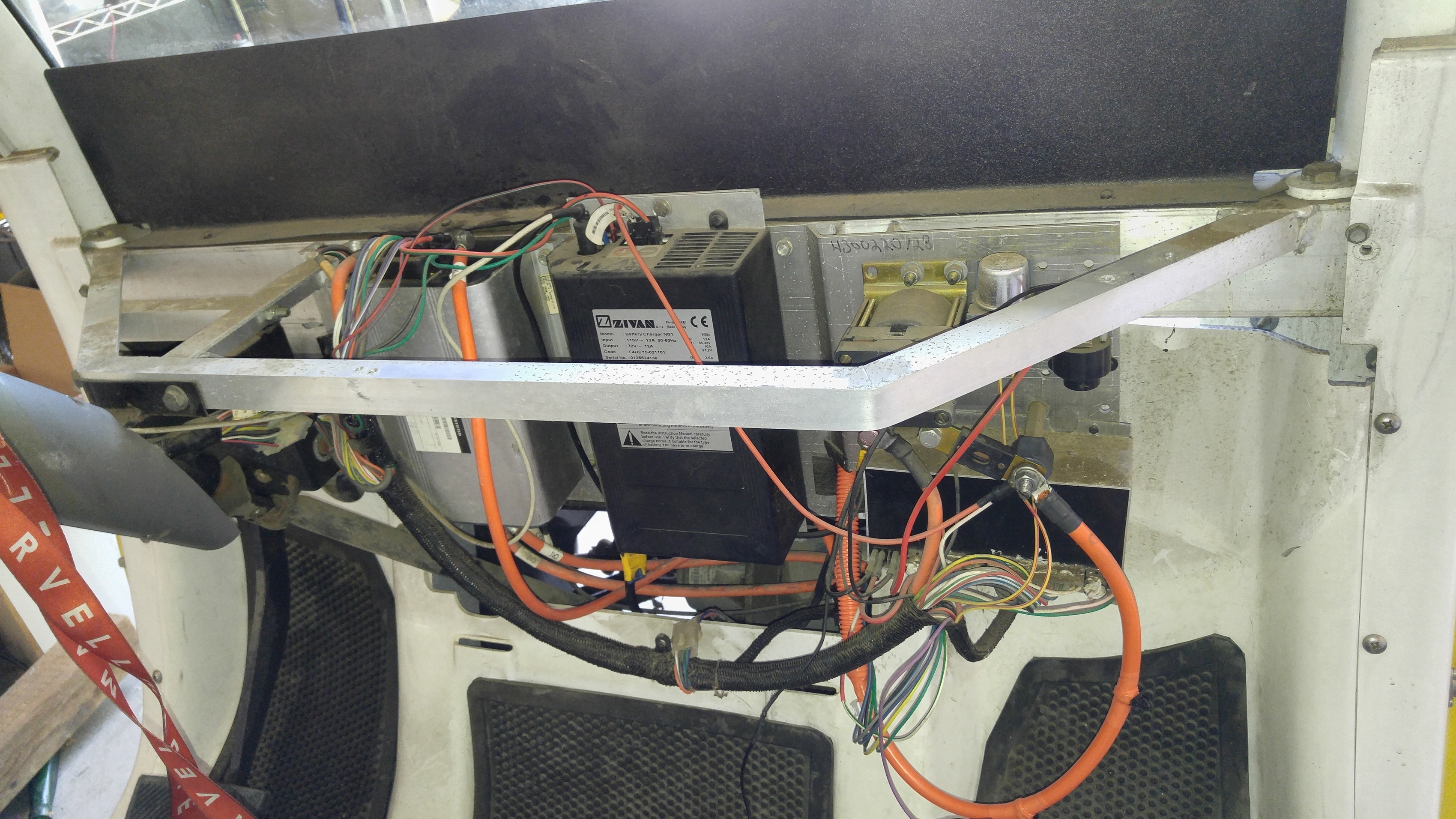

Just have to bolt em dn.20 modules no FLA for ballast
Very nice.
Make sure to take care of them for long life.
Check balance every charge cycle until you can trust them.
the vohm meter shows how to hookup the bms
if you rely on this chickenscratch on this piece of paper; you will ■■■■ it up!
Yes, definitely check 9 pin plugs before plugging into bms.
This was a picture from Troy, that he wanted marked as to strap connections. I just added the numbers to be helpful.
Kind of a harsh assessment. It looked clear to me.
Does it seem correct?
I will delete it if it’s incorrect or misleading.
The two of you are working together?
Same setup?
The front to back orientation of the battery pack to the vehicle seems wrong and confusing. Do the 4 seaters
have a tunnel in them from back to front that I don’t know about?
Also, I thought you were showing him how to hook up the bms, too on this paper. In any case,
a Vohm meter should be used to make sure.
I have to group them together differently. I just thought he should double check with Vohm meter because he is not a chiphead; neither am I for that matter. Isn’t his battery pack going to be oriented 90 degrees differently; under the seat?
I replied to his picture in an email and told him exactly the same thing.
Use a meter every step.
Check for zero volts before bolting on each strap.
I didn’t critique his drawing. Only added the connections to what was there.
If they fit like that, it will be a nice setup. I think my truck is similar.
That’s what Grant thought too.
Yeah, he just sent me a video with the normal battery orientation which is 90 degrees different from diagram…and
being held down by the stock FLA battery bar. I couldn’t use that stock bar with 2 seater.
