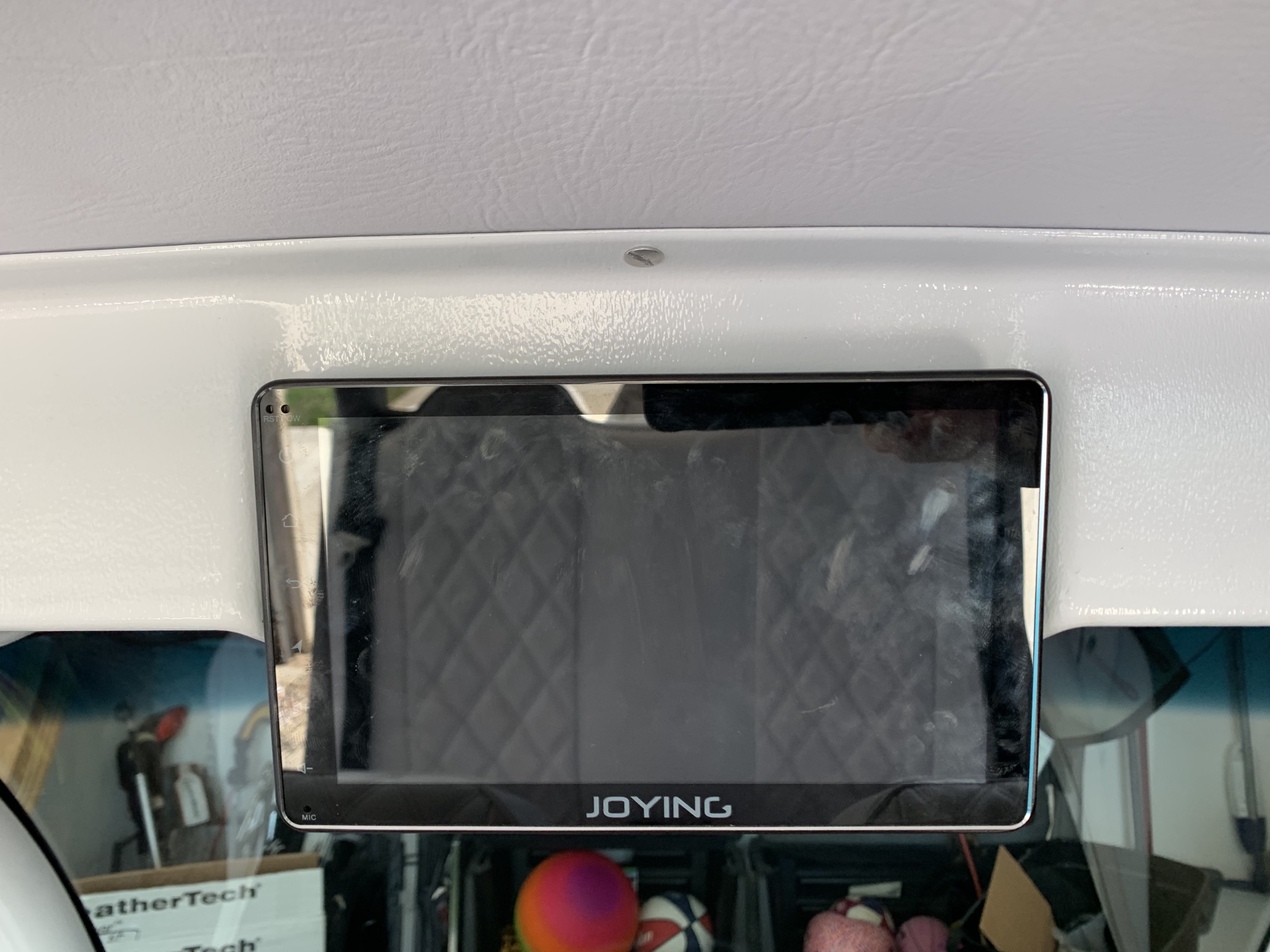

In the center of overhead console that is a 8” joying android car stereo. I used this stereo because the radio chassis is a single Din. My double Din Kenwood did not fit due to there is not enough clearance between the roof and the console for this application. These car stereos are not as hi quality as a Kenwood but being that it has a Android os with full google play app access the possibilities with this thing are endless.
