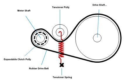

Here’s a picture of what I came up with. It should work as long as I find the right kind of centrifugal clutch to expand the motor pully ratio…
When the motor runs the clutch will expand causing the tensioner pully to rise up and keep the belt taught. The tensioner spring will be just strong enough to keep the tensioner pully in check. Hopefully this will allow for a starting 1:3 ratio and top out at a 1:1 ratio allowing for faster speeds.
Looks good no?

HOW FAST do you need to go… seriously. Series wound motors are good for 5-6000RPM, AC is good for even MORE RPM. 1:1 ratio running 5000RPM on an 24" motorcycle tire (thats the total diameter) would give you 356 miles per hour… and that’s just not even possible (or remotely realistic). Even above 60-70mph would be hard due to wind resistance.
I think you need to do some gear calcs.

I just don’t see the point in having an adjustable gear ratio, motors have a flat power curve, and you START with 100% torque. There isn’t a power curve like an ICE. As the RPM’s increase, voltage increases and the Amps decrease, but the power stays fairly constant. If you want an adjustable ratio, use a CVT… thats basically what you’ve explained.
