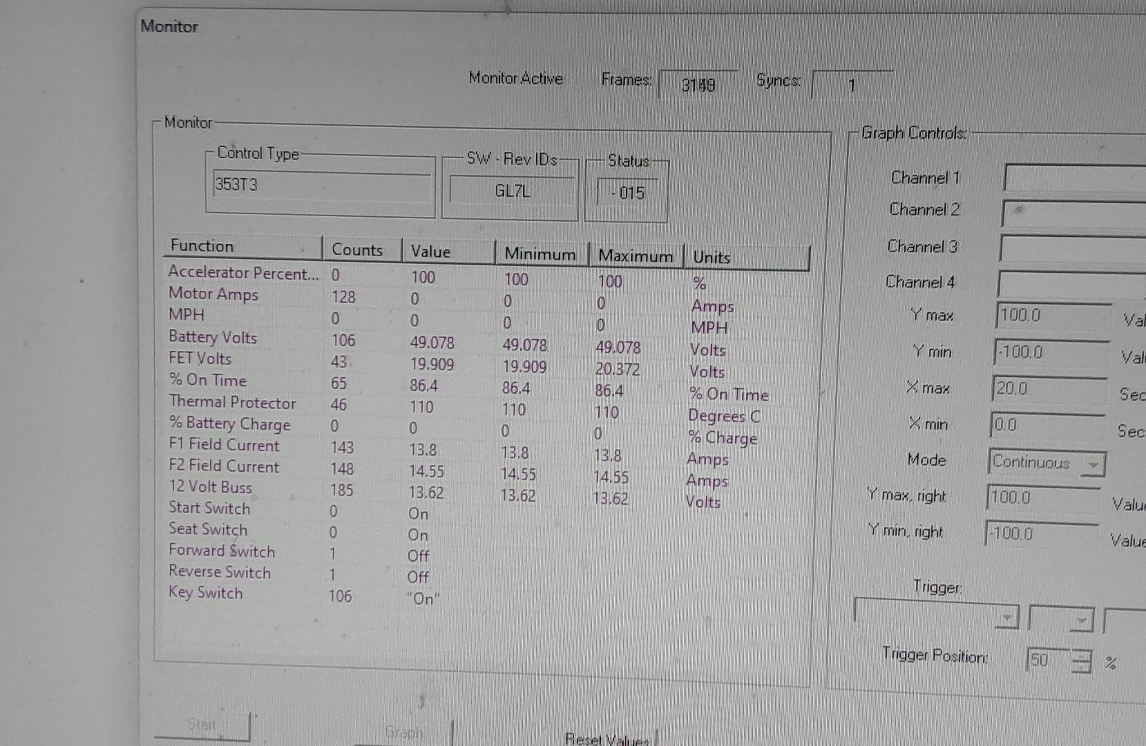

Is there anyone using the sentry monitor function?
I needed it today to measure % of throttle on a T4 controller and it didn’t seem to work. Tried it on two “bad” controllers, but doubt both would have a throttle problem.
Possible it only works in a running car.
Also possible that it only works with early fw. T1-T2 etc.
Will someone connect to their car and help me out?
I tried graphing the start switch plus throttle. That did not work either.
This is a great trouble shooting tool. Must be someone using it.
If not ill take you through it.

I just wonder why I can’t get Sentry to monitor throttle %. Other monitor functions work fine.
