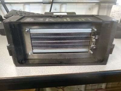

I couldn’t figure out how to post a new topic so I decided to ask my heater question here. Does anyone have experience repairing the heater. My fan blows but heating element does not get hot. I have 72 volts at the heater. Opened up the heater and there is a part which appears to be damaged. I’m not an electronic guy but it appears to be a thermal fuse.

Thanks for the info but it Doesn’t look the same as what I have. Is it possible that’s for a newer Gem? I have a 2002.
No, generic heater. For parts or such. Like @AssyRequired said. They are all pretty much the same parts wise.

Found some pics of the unit -
