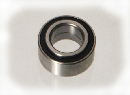

These aren’t tapered bearings that can be tightened to adjust. I believe it’s one wide sealed bearing.
If it was the tapered bearing type, I could have turned the nut 1/4 turn.
Unless the el uses a different bearing than the elxd it requires 1 bearing. Theses are spherical bearings that are designed to handle lateral forces so you don’t need 2 like with tapered roller bearings. I’ll get you the part number so you can buy it online or from an atv dealer, it’s considerably cheaper than getting it from NEV.
The bearing number is dac305530/25,2rs. I believe this is off of a 2002 arctic cat 500 4x4 atv, if we someone can do some more research and find out for sure then we should be able to get all of the suspension/ steering parts for our gems from aftermarket instead of Polaris or not being able to at all.
