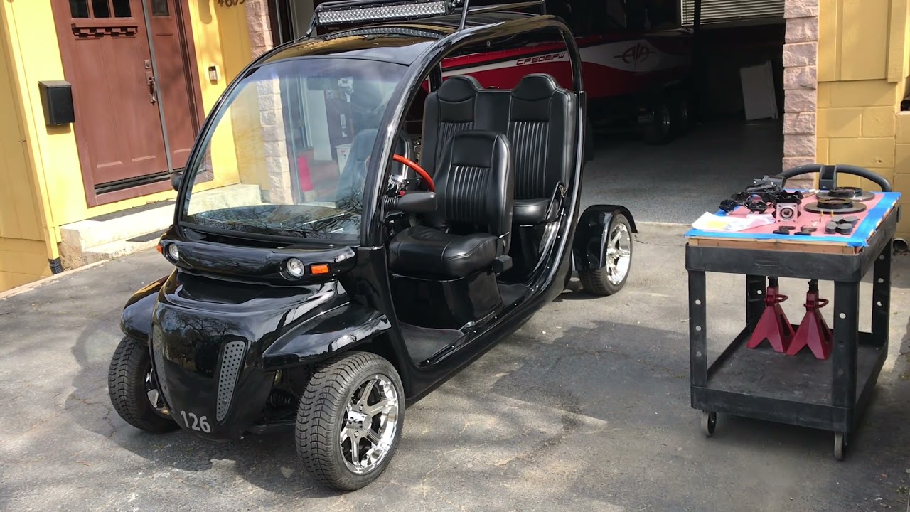

Here is a video of me doing a Disk Brake conversion on a Buddy’s 1999 Gem. This is the Kit that Nevaccessories.Com sells. I think the kit was around $680 and requires you to send in some of your Original parts as a refund/core charge. Hey please do me a favor. If the video helps you please give me a Like & Subscribe
Then the next step is to remove the drum assembly. This can be done very easy. Remove the 4 13mm bolts at the back of the drum. You will need a socket and ratchet. Once the 4 bolts are out the entire drum assembly can be taken off. You will also need to disconnect the brake line.
The picture shows the drum assembly taken all apart but you can skip that and remove the whole unit as one piece
Next step is to bolt the New hub to the spindle.
The kit comes with 4 short bolts and 4 long ones.
The short ones go in the back (they are the ones that have the lock nuts on them) the longer bolts go up front and attach the disk brake mount.
Next step is to attach the caliper mount. The larger radius mounts flush with the hub. The threaded holes are what the Caliper bolts to
Next step is to put the disk on the hub. Throw it on and use the supplied lug nuts to hold it in place they only need to be hand tight.
Then Mount the caliper. I used some blue lock tight on the bolts holding the caliper on.
The next step is to attach the brake lines and bleed the brakes and then take it for a test ride
