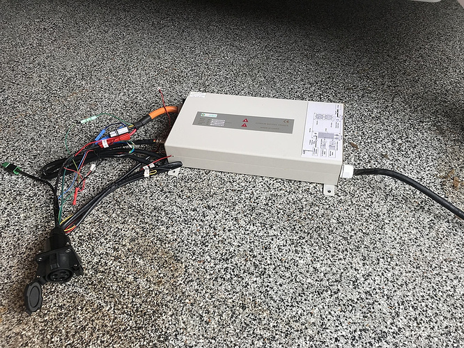

Here I built the J1772 comms into a DQ charger. 12v supplied when connected to Gem battery.
Plug 2 wire anderson into Gem. Power it from public charging station.
This will add $250 to the price of a DQ or use the DQ to J1772 adapter box shown previous.
The Vehicle input wires were not shortened, as I’m not sure how this might work for you.
I guess it would be cool if the J1172 plug had a 3-4 foot pig tail coming off the charger so you could remote mount the J1172 plug box.

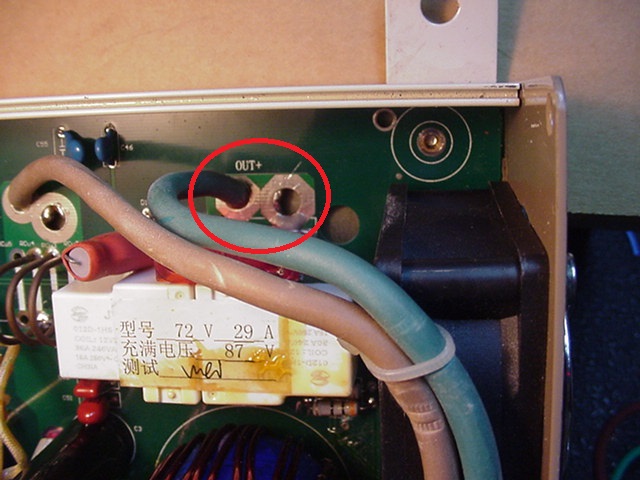

If you’re up for it, I may be able to instruct you on the modification, so there would be no need to ship it back and forth.
I’ll start here:
Find these 3 pads. All are B+ out.
Goal is to cut trace where easy to get at. Use exacto-knife or bit in a tip cleaner drill.
Find this area and orientation of charger.
After cutting trace in 2nd picture, (middle of board), Check for lost continuity from B+ out pad to bottom pad in 1st picture.
When some brave soul gets this far. I’ll post the single component hack.
