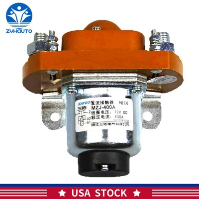

Can I use any 72V contactor. I found several on Amazon prime for 100 and the GEM replacement is 280.00
Has anyone used an aftermarket contactor? Luck? Recommendations? Issues?
I have used three or four of these - they work great.
This is one i was looking at. How often have you replaced this part?
Only once per car, it has been four different cars over the years.
