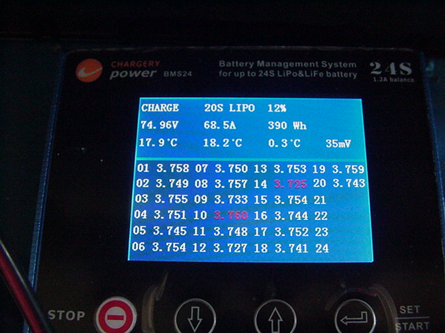

I personally don’t think Battery cooling is a issue. The most I have EVER seen from my car is a 260Amp draw at take off and then down to around 200-150 amps on a regular heavy pull. So I don’t think Gems can pull that much power to cause a hot battery. But it would be a good idea to keep a eye on it. Tyson’s Battery has a Temp sense on it where he can see the battery’s temp on the Dash via the BMS so it will be cool for him to report back Battery temps as he drives. Example you can see on the lower right hand side of the BMS display his battery is 67 degrees right now.

Ya, I see the sensor taped to the top of the top battery. Basically in the place where it would be the coolest. I would have put it in the middle or back of the bottom battery between the two batteries.

Might be soc indicator.
@grantwest, how does your soc work?
20s I’m testing shows 11% at >3.7v.
Temp sensor connected.
Does it work from AH? Meaning that shunt must be connected properly and soc goes up with wh put in.
I’ll soon know. Jason keeps messing with fw.
He never put in our big ammeter screen either.
Hey! I believe I know how to fool wh reading to speed up my testing.
I’m telling bms that I’m charging at 100a. (68a shown)
Wh should come up fast. It needs a preset in menu.
Or is there? I’ll look.
That was my next thing. The SOC at 3.9 is at like 3/4 over and when I get down to 3.7ish it is in the yellow. I had a bunch of kids on it and really wasn’t paying that much attention to the SOC my son was the one that pointed it out that I had only half charge left. I knew since it read 3.7 I had plenty to go from @grantwest I will test more this weekend and report on SOC. My WH still says 0.00… Do I have that wired wrong? when I drive it does read -##Amps while moving? my Regain does not kick in at all which I really want to happen to help slow down.
Shunt wires might be backwards. WH can’t go below zero.
Run battery empty. <3.5v.
Connect charger and watch wh go up.
Should take ~8,000-10,000wh.

#2 just switch the black and red wires on the shunt. No worry’s about breaking anything you can do it hot. One way the BMS will read - when your pulling amps and it will just say a number when your charging or in re gen.
Don’t pay attention to the rainbow gauge it’s in accurate. Pay only attention to the cell voltage. And you can only tell the cells voltage when the car is stopped . Again it’s in accurate when the power is being drawn
