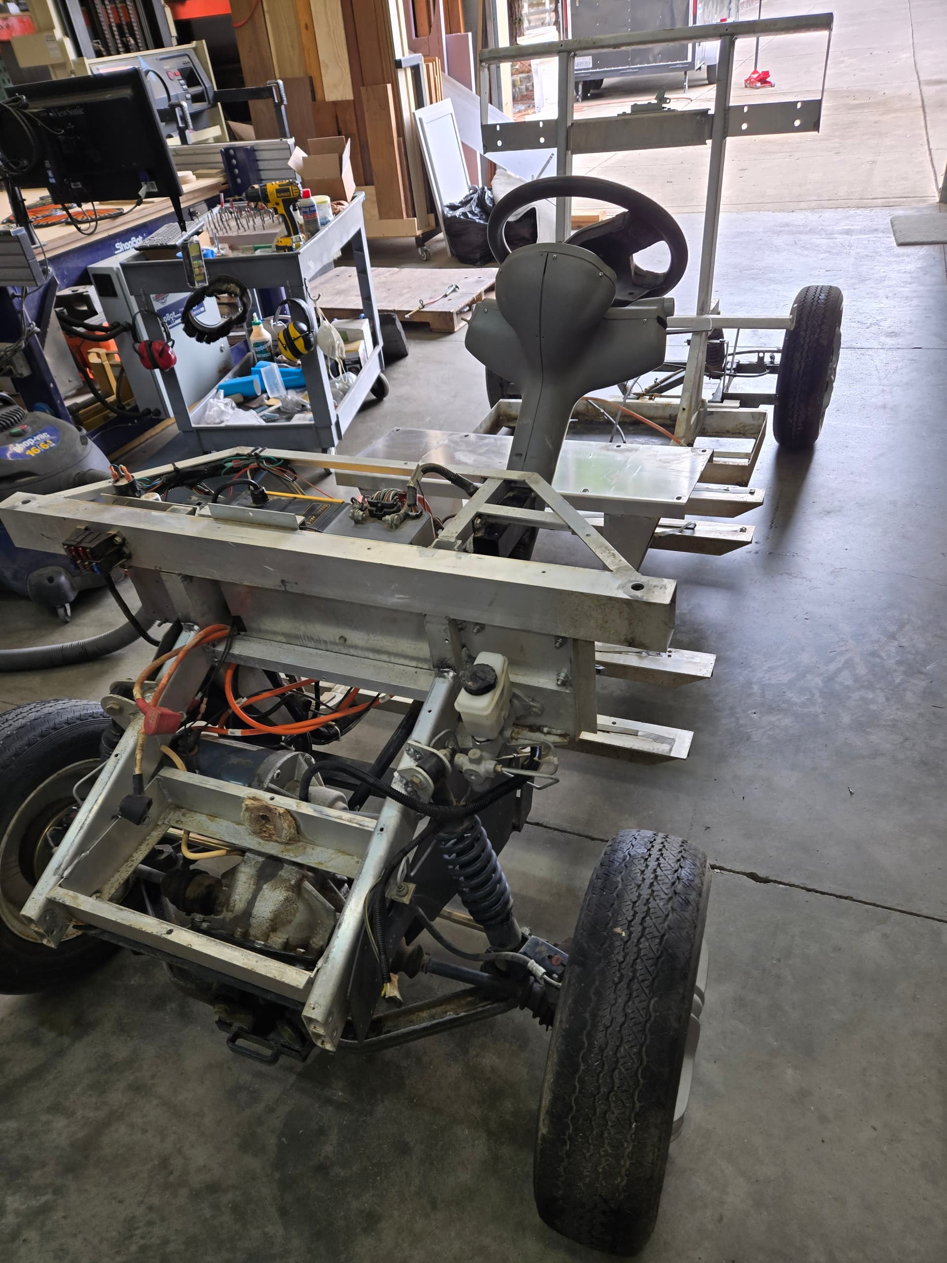

So I got the drum off but can’t get the hub off now. The bearing is nice and smooth but I really wanna clean it up. Got any hub removal tricks you can share?
Leave the hub/carrier assembly complete. Remove the assembly via 4 bolts at the mount.
If you are doing the front, you will need to remove the nut/axle stub too.
I had a friend that is a mechanic come over and we were able to remove the hub via a pulley puller and a good wack from a hammer. This thing had been sitting outside in the weather for what looks like years. Guy I bought it from said batteries dies a year ago and it was parked… turns out that could not be true… So, anyway, I want to clean the rust and corrosion off these carriers and squirt some paint on them. I ordered replacement kits for the pads (which were not actually worn) springs and cylinders. I figured cleaning them up couldn’t hurt before putting them back on.

Hmmm… Inspect this car carefully. How much rust are you finding?
Inspect all the bolts involved in the suspension, maybe even the the steel parts of the suspension. Is there unreasonable rust on the lug nuts? (were they tough to get off?
Keep an eye out for weird signs of a high water mark on the inside of the body panels. Is this car just overall rusty?
While you are working around the rear suspension, Inspect that rear swing arm for cracks. They are prone to cracking around the areas around the rear spring mounts.
No high water marks… the shocks themselves aren’t really rusted that bad visibly, but they do have some rust. The bolts also have some rust.
Those joints had already had 1/4" plates welded on them. (I had to do that for a friend so I was aware of that issue). I didn’t do it on this one but it had been done.
To finish answering your questions… there was some rust on the lug nuts but nothing I would consider out of the ordinary.
There is general over all rust on steel parts.
