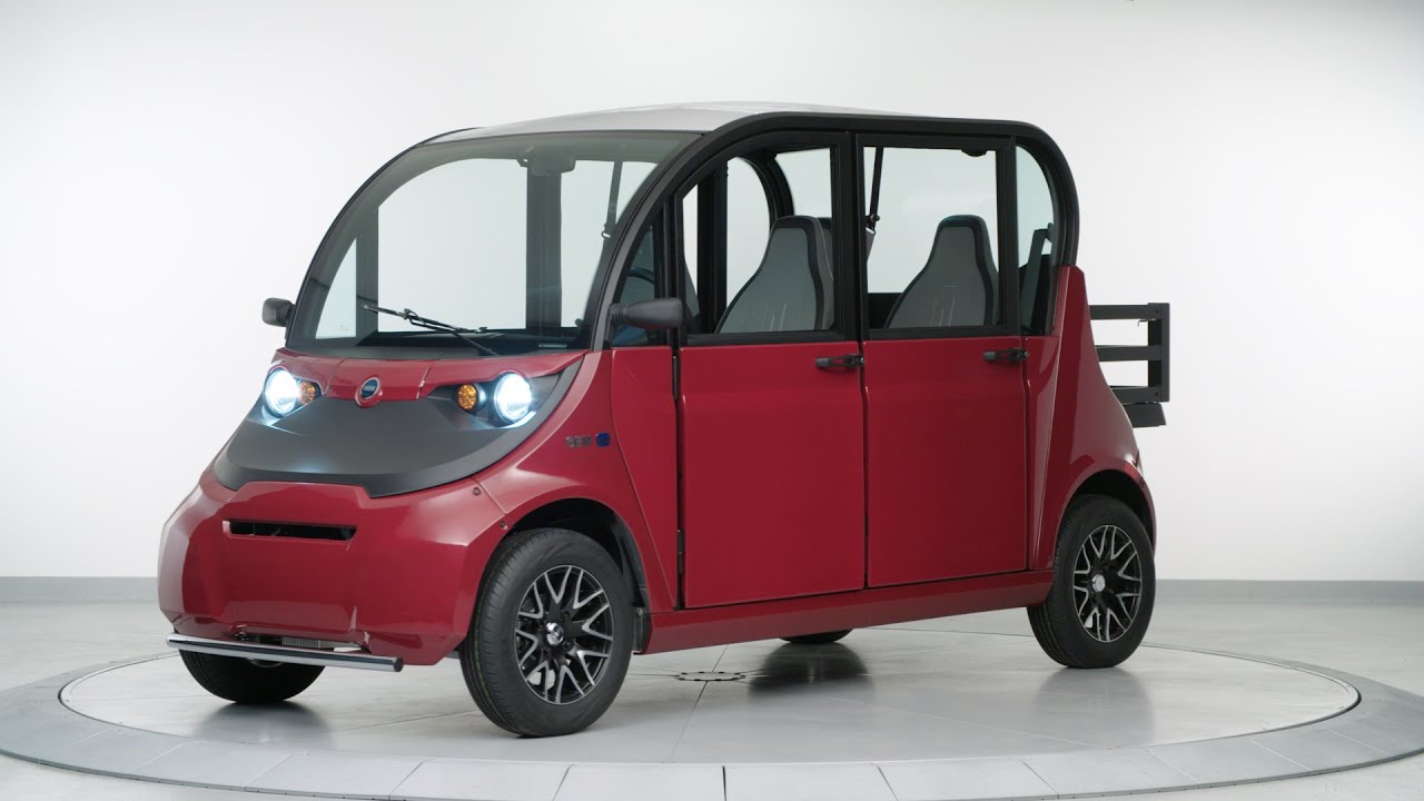

according to this it has independent trailing arm rear suspension…
Still, if the back bumper is bent and there’s a hitch attached the frame back there could have been compromised.
With IRS trailing arms, I doubt a hit would affect both rear wheels the same way.
Unless that bump and/or trailer hitch attached to the center of the frame structure both arms are mounted and pivot from… Not rocket science so looking at the frame and stuff to see if anything is bent should quickly eliminate or prove a structural issue. Otherwise it’s over weight and/or sagging rear springs.
