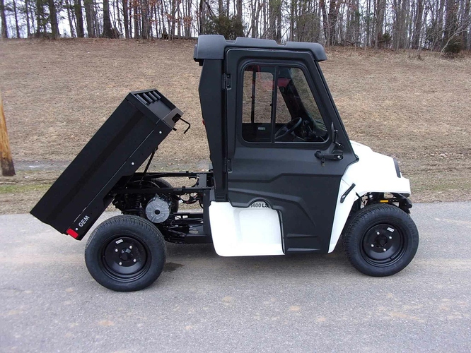

You guys seem like the only people on the planet trying to give these new gems more horsepower. Doing awesome work. I live up on a mountain and these things struggle to get 18mph up. I will definitely buy a kit when everything is solved! Btw will the GEM eM1400 run into other problems? From a glance, it seems to have plenty of space in the rear.
Donât know much about the 1400. Only drive train image found is:
I would think a 7hp motor would go uphill.
If itâs a 19 spline standard motor the big a.c. motor should fit.

From what I see nothing is in the way. Love the rear set up.
