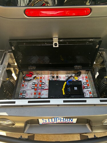

I can get you the exact specs on my battery but it’s a 48 V lithium hundred amp hour is there anything more that you need to know than that?
I am running two of those batteries
Yeah… That’s almost like saying you think it’s a blue one.

we need the specs of the batteries, a link, model, specs sheet, pic of the label, would help.
Seems for what I can understand that you’ve got LFP Batteries.

How about just typing in the specs from the receipt?
Or pictures of the batteries, charger, inverter, converter, adverter or whatever y’all bought.
Can’t really help you with out knowing what you stuck in the thing.
It appears that website is still very much under construction.
I couldn’t find any details either.
48v 100ah. 49lbs 150a/450bms.
I installed two of these.
