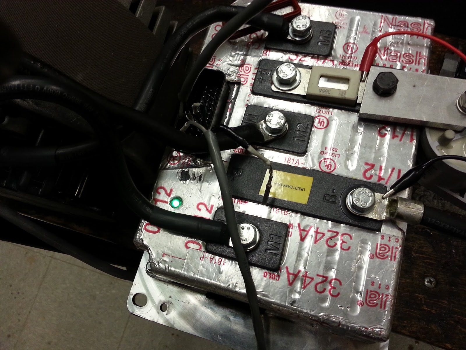

Hi
its the new with AC motor ?
look on controller if Green Led flash any code
