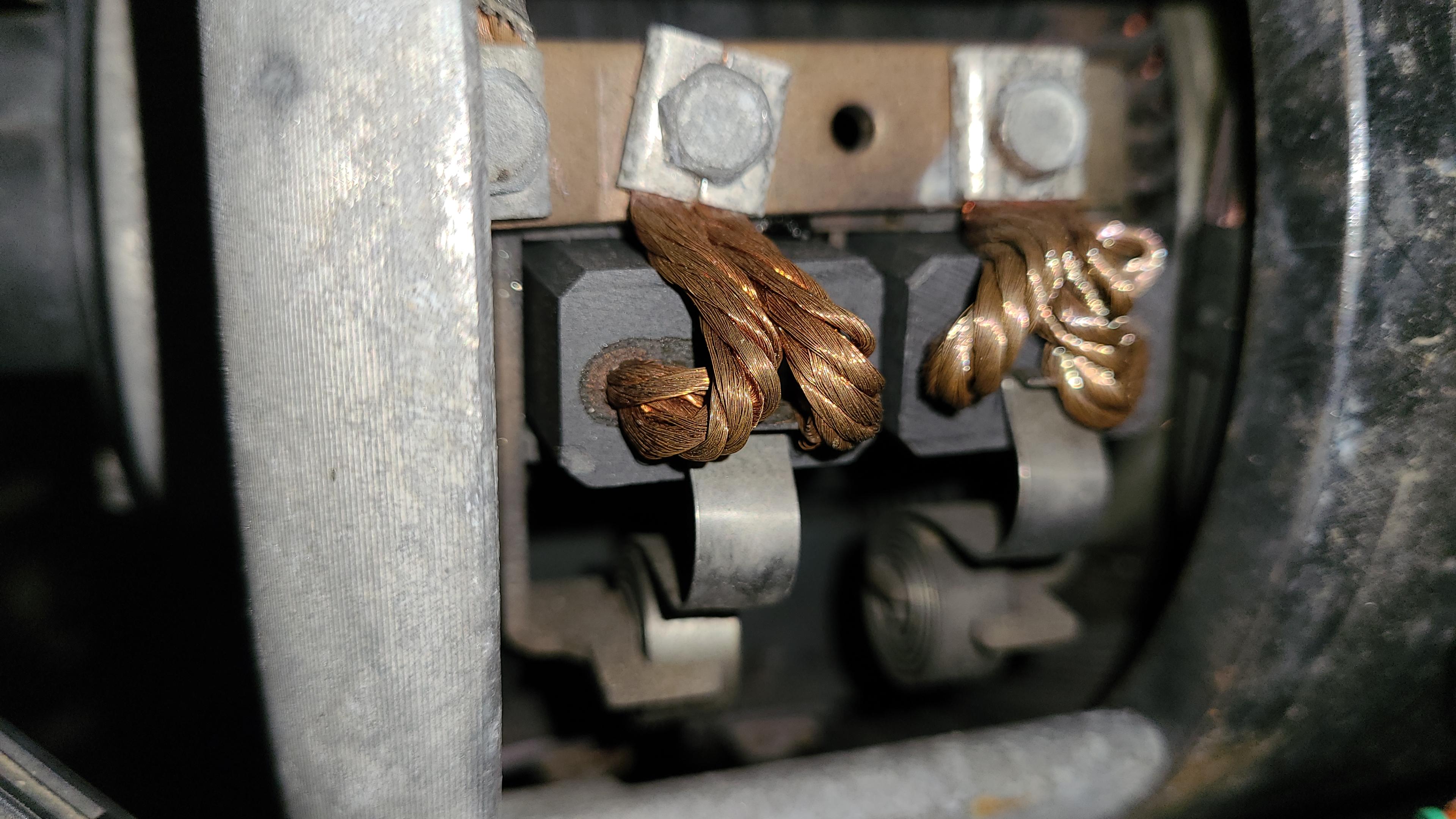

Now- see if you can figure out how to remove that shiny cage/grille with diamond shaped holes and get a couple of pics of what it looks like in there. Use a flashlight if it is too dark or see how your phone light works out.
The commutator is all the way down in near the middle and looks like a bunch of piano keys. You will see the brushes in paired racks pointing in towards and rubbing at the comm keys.
Any idea why those brush springs are not wound up and placed pushing down on top of the brushes?
It won’t work correctly without them properly in place.
And if that is the commutator below the loose brush springs that commutator is charred and is in BAD shape.
maybe someone did a brush replacement and failed… Not a good setup.
Ding, ding, ding!!!
As dougl pointed out, those springs in your pics were never released from their service positions. Depending on how many are like this it would TOTALLY explain what is going on.
If you carefully (one at a time, hold on to it tight) move it towards its mate and it will come off that tab and unwind a bit, so the hook of the spring will land on top of the brush. It should look like your first pic. Do this to both brushes.
There are 4 sets of these brushes all the way around the motor. You might not be able to reach one set due to lack of room down there.
BUT (and its a big but) Your comms are also extremely scorched because the lack of good brush contact probably caused some big blue arc down in there. That might have been the smell (ozone).
You could release all springs(making sure the rolled foot lands on a brush) and there is a slight possiblilty that it will clean itself up a little, but I doubt it. Having dirty comms is a good way to blow up the controller.
It would be really nice if you could take this motor out and get it serviced.
This is a great motor and if you treat it well it will pull you along nicely.
