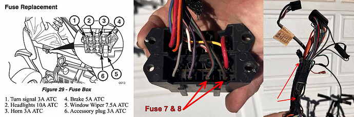

I recently studied your Gen1 fuse block and found out that there are two undocumented/unused power circuits in your car all wired up and waiting for fuses to be plugged in.
Note the two empty fuse slots. If they were populated, they would be Fuses 7 & 8. On the back (if you were to remove the fuse block and look) You may find wires attached in these empty slots.
On my sample harness I found the Wire colors are
F7 - Grn/R
F8 - Brn/R
This also happens to be the origin of the famed Purple wire. (fuse 6)
All of these wire exit the Main Harness up by the controller.
They might be all taped up and tucked in somewhere.
