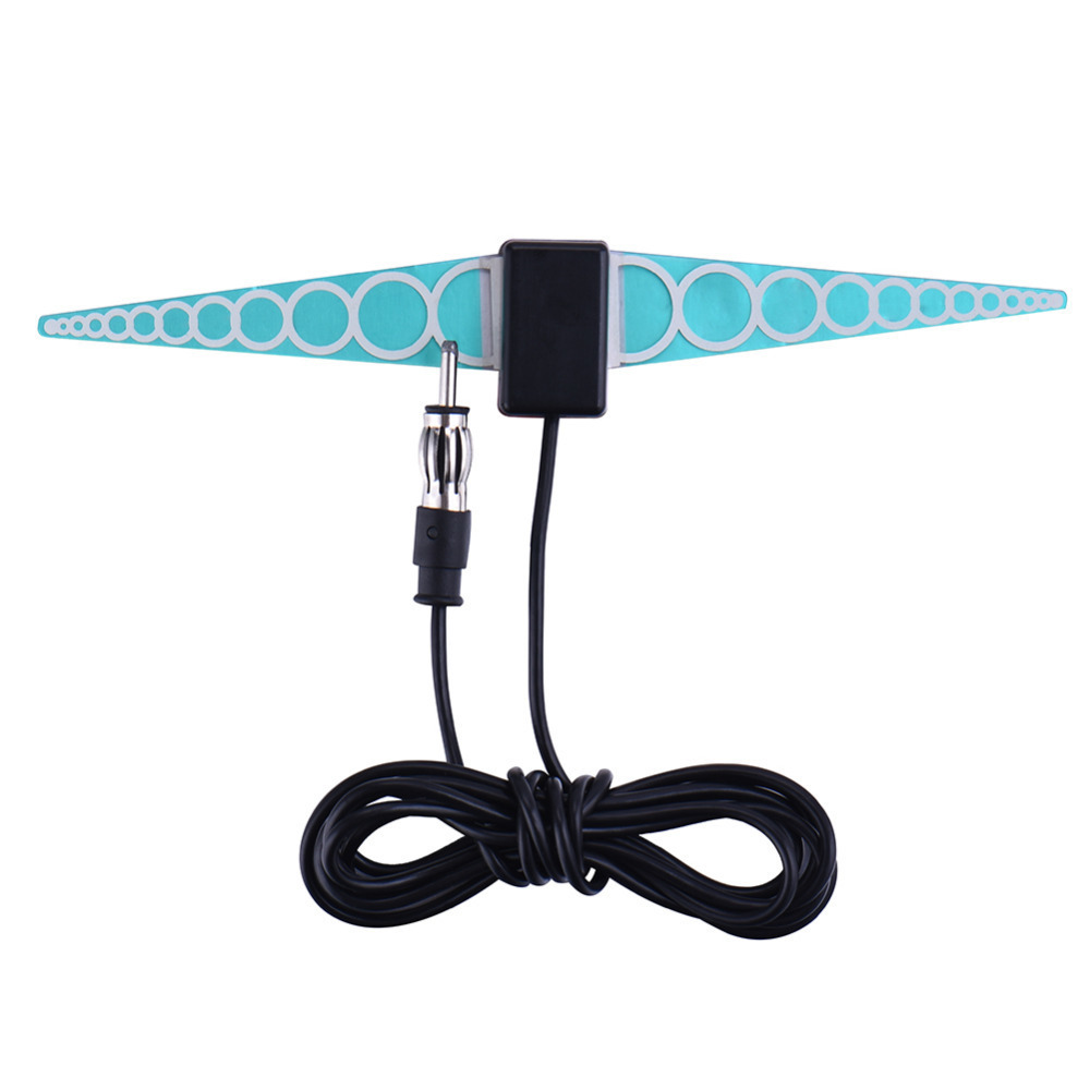

Here’s some without power injected.

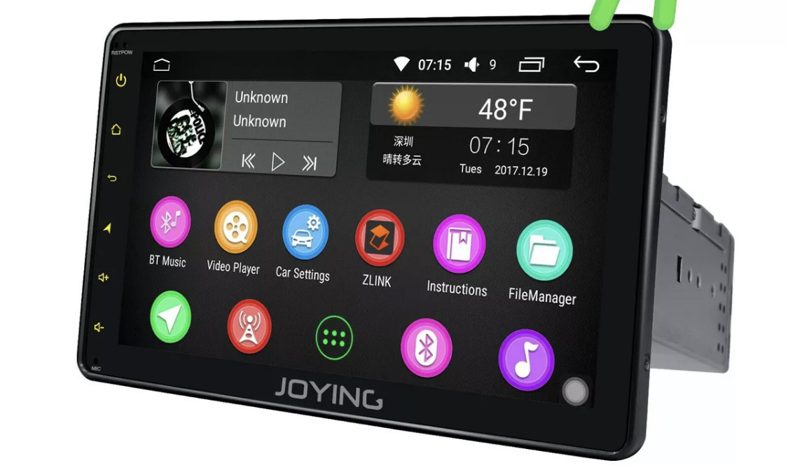

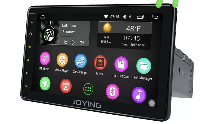

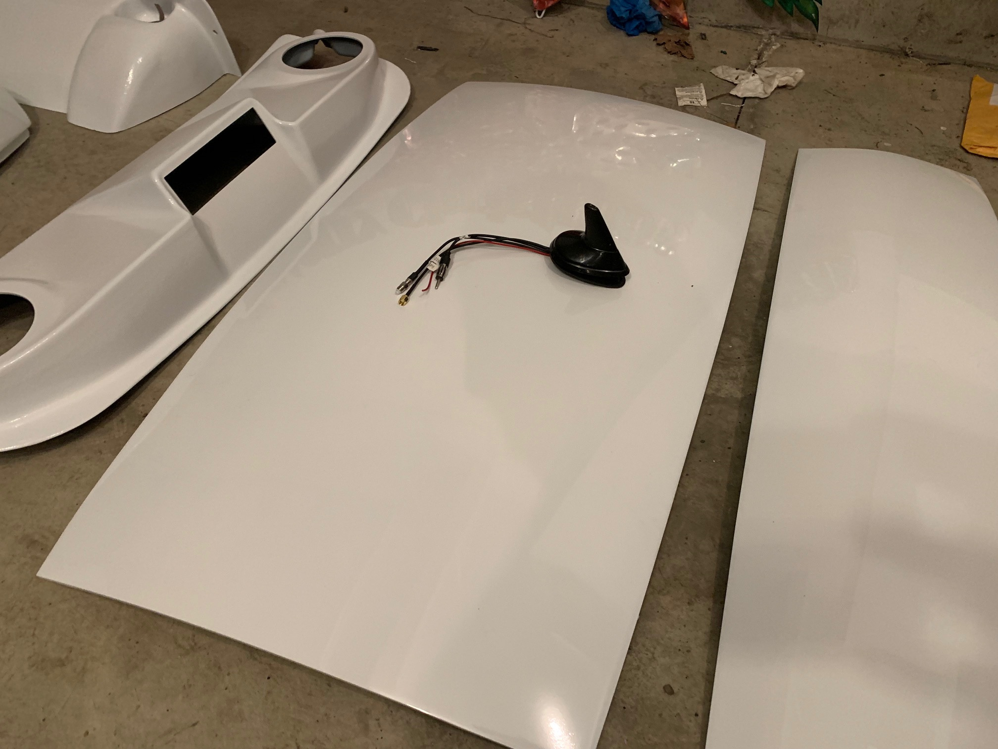

Just got everything back from the paint shop today and have had the same thoughts about antennas with a overhead console. I am installing a Joying 8” screen that has a single din receiver on a separate stand alone battery. For the antenna I decided on a powered shark fin that does GPS/Sirius/am-fm & digital. Will update once I get installed and everything working.
