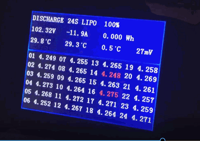

Beyond that, I recommend a monitor.
$350 , But then, I would, as I sell them.
