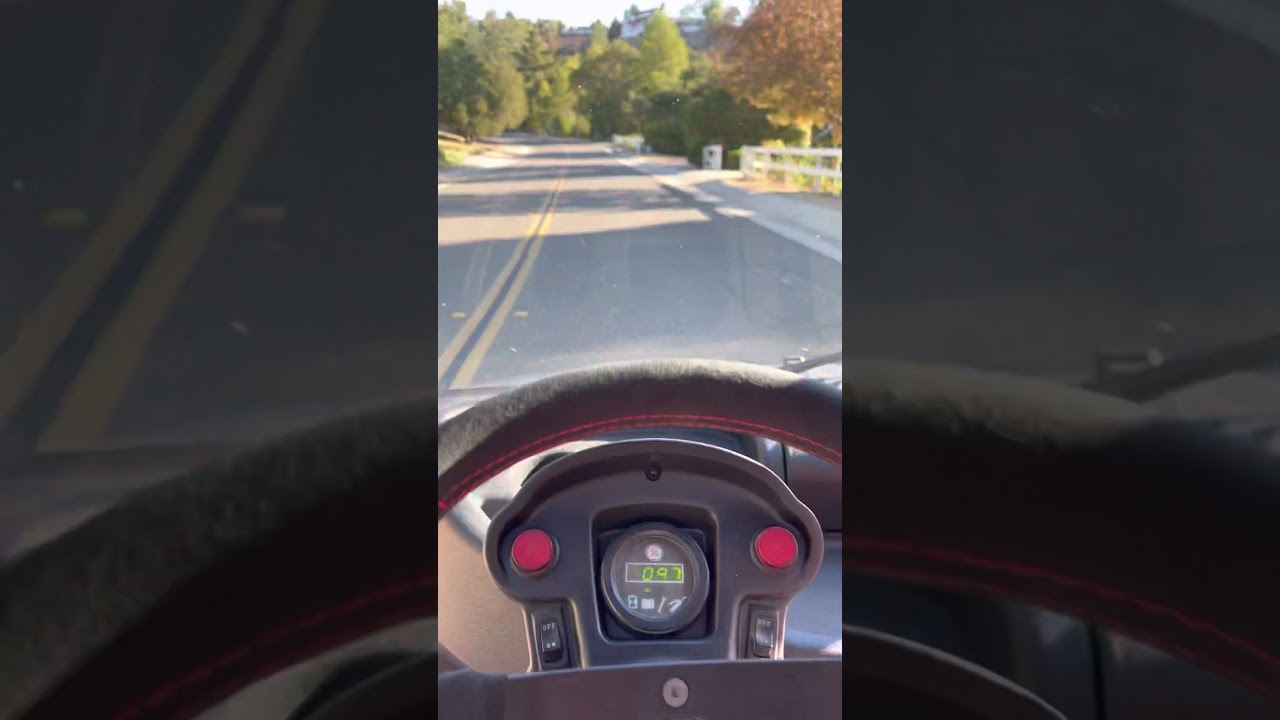

Took a video of what’s happening. On the flats I can get 25-30mph. On the hills about 15. Would lithium help me get to 25+ on the hills and longer overall range?
Honestly, you’re about to build a money pit with shitty steering and crappy brakes.
Nothing you can ever do to fix the steering on the 01-04. Very little you can do about the suspension. Brake upgrades are like $700.
Get rid of this one, and get something 08 or later.
You’ll be much happier
Appreciate it but the $ is already in. So going to make the best of it even if it’s another couple k
