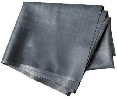

I purchase a pond liner off amazon and cut mine to size. worked for inside the Gem and covering the batteries.
