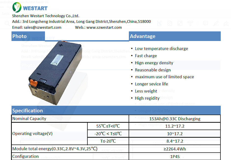

Looking for newest and greatest? I’m getting ready to list a complete battery system.
Includes plug in harness and bms.
Like this one but 112ah. A little lighter but twice the green cells range. Lcd and bluetooth cell monitor.
$2000 complete. 20s takes 5 modules to replace 6 lead. Add another anytime for 22s or 24s.
80v 84v 88v

Yes, I built a custom harness with proper plugs to battery modules.
Each module is 4s (cells) 14.6v nominal. 5 * 5 = 73v.
Maximum safe charge voltage is 4.15 * = 83v.
Your DQ charger can be programmed to proper voltage. There is no better charger than DQ. They can fail as can anything. With millions out there, you hear about lots of failures. Most are water intrusion.
If you are interested, I’ll connect it to bms on the bench and show you the display and cell volts.
Batteries are protected 2 ways, charger setting, plus the bms. If any one cell is full, bms stops charger.
