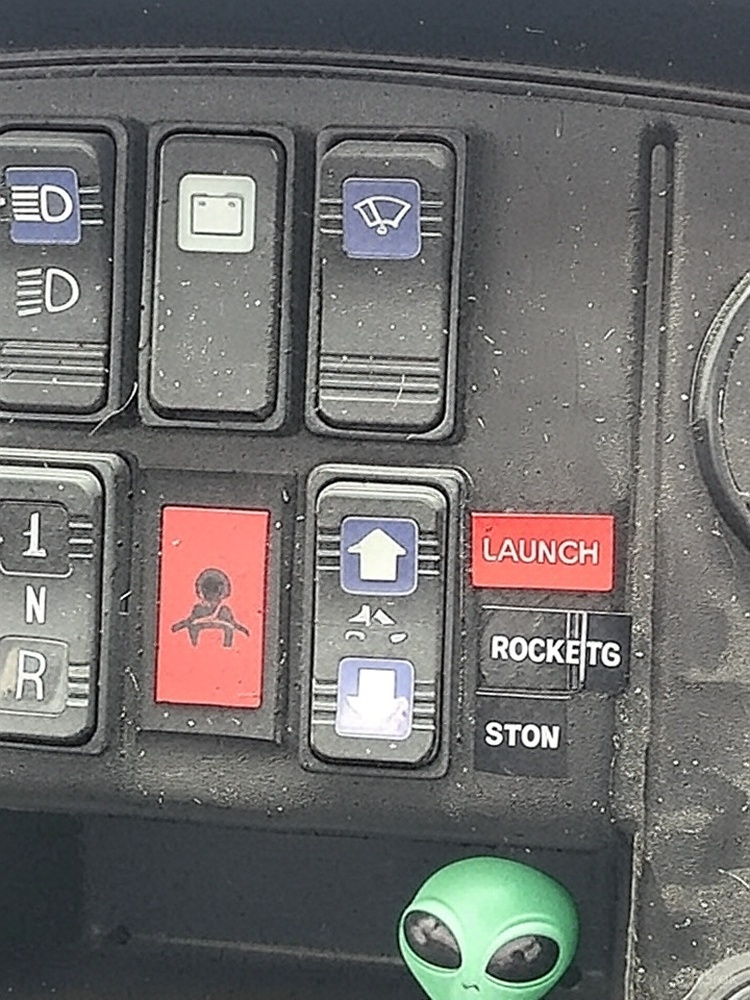

No. But do you have one of these?
Looks like yours is the older model. Mine looks like this:

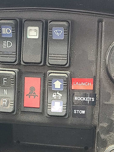

Note: This post is asking about a 2018, but the pic referenced mentions this switch in a 2024.
Is there a Regen switch in a 2018?
Perhaps the OP (eltakeiteasy) wants one of these switches in his 2018?
The overused term “hacked” is not a clear request to what actually needs done here. → More info is needed.
2018 Polaris and 2024 Waev are just different animals. I suppose there might be some way to adjust Polaris regeneration but I don’t think it’ll be easy to put the Waev button on the dash and working.

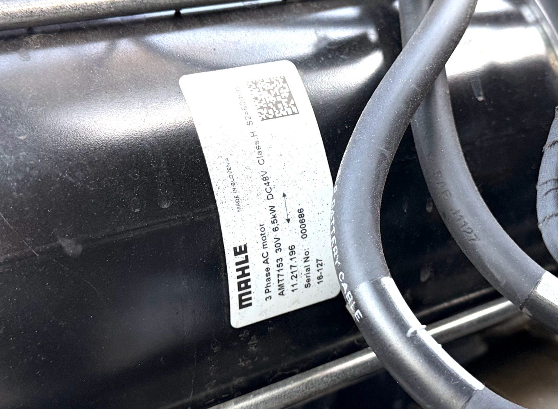

2018 5kw motor ?
Battery?

I am in San Diego. Background is mechanical engineer.
Here’s the motor I have:
